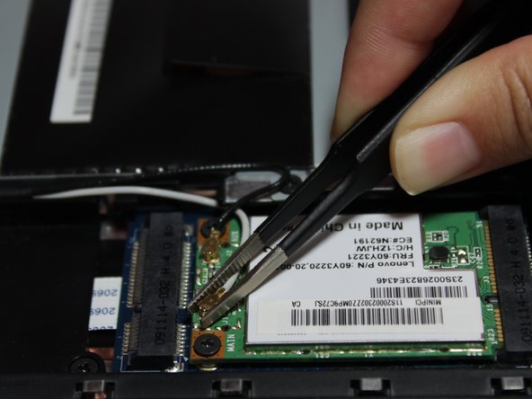

    • The WiFi card is found near the bottom of the panel.
  4. Lenovo IdeaPad S10-2 Wireless WiFi Card Replacement: crwdns2935265:04crwdnd2935265:01crwdnd2935265:03crwdne2935265:0 Lenovo IdeaPad S10-2 Wireless WiFi Card Replacement: crwdns2935265:04crwdnd2935265:02crwdnd2935265:03crwdne2935265:0 Lenovo IdeaPad S10-2 Wireless WiFi Card Replacement: crwdns2935265:04crwdnd2935265:03crwdnd2935265:03crwdne2935265:0

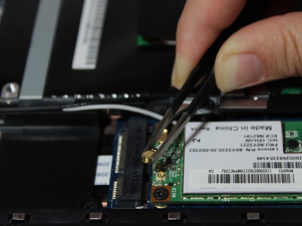

    • Do not use the metal precision tweezers as shown.
    • Using the blunt end of the spudger, wedge the spudger beneath the connector and pull straight up to remove the white wire. Repeat to remove the black connector.
    • When reinstalling these U.FL connectors, hold the connector in place and gently push down. The connector should snap into place like a button.
