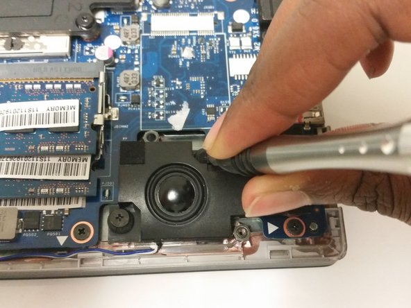

  16. Lenovo IdeaPad P400 Touch Speakers Replacement, Speakers: crwdns2935265:016crwdnd2935265:01crwdnd2935265:02crwdne2935265:0 Lenovo IdeaPad P400 Touch Speakers Replacement, Speakers: crwdns2935265:016crwdnd2935265:02crwdnd2935265:02crwdne2935265:0
    • Remove the two 8mm Phillips #1 screws holding the right speaker in place.

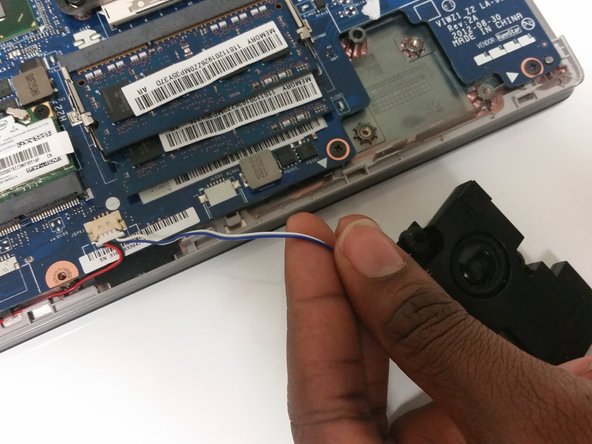

  17. Lenovo IdeaPad P400 Touch Speakers Replacement: crwdns2935265:017crwdnd2935265:01crwdnd2935265:02crwdne2935265:0 Lenovo IdeaPad P400 Touch Speakers Replacement: crwdns2935265:017crwdnd2935265:02crwdnd2935265:02crwdne2935265:0
    • Remove the right speaker.
    • Gently pull the blue and white wire out of its plastic clips.

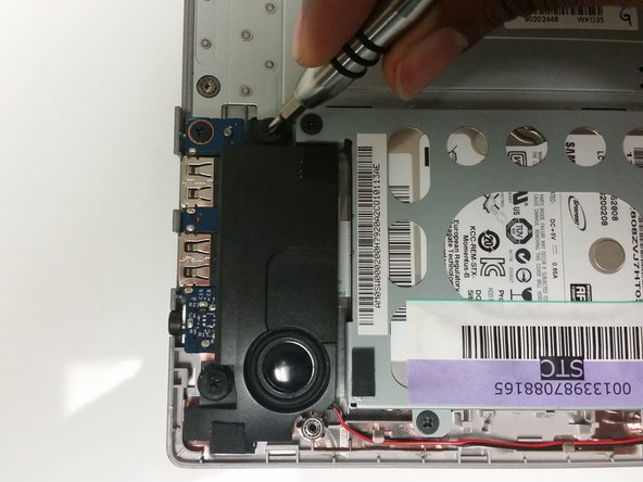

  18. Lenovo IdeaPad P400 Touch Speakers Replacement: crwdns2935265:018crwdnd2935265:01crwdnd2935265:02crwdne2935265:0 Lenovo IdeaPad P400 Touch Speakers Replacement: crwdns2935265:018crwdnd2935265:02crwdnd2935265:02crwdne2935265:0
    • Remove the two 8mm Phillips #1 screws holding the left speaker in place.

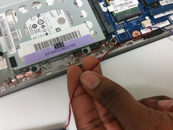

  19. Lenovo IdeaPad P400 Touch Speakers Replacement: crwdns2935265:019crwdnd2935265:01crwdnd2935265:02crwdne2935265:0 Lenovo IdeaPad P400 Touch Speakers Replacement: crwdns2935265:019crwdnd2935265:02crwdnd2935265:02crwdne2935265:0
    • Remove the left speaker.
    • Gently pull the red and black wire out of its plastic clips.

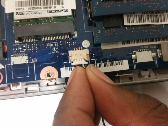

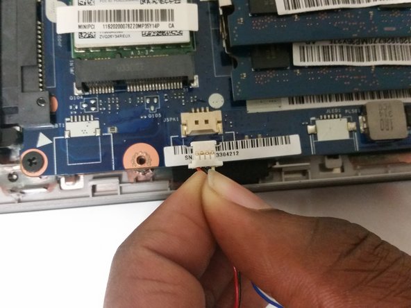

  20. Lenovo IdeaPad P400 Touch Speakers Replacement: crwdns2935265:020crwdnd2935265:01crwdnd2935265:03crwdne2935265:0 Lenovo IdeaPad P400 Touch Speakers Replacement: crwdns2935265:020crwdnd2935265:02crwdnd2935265:03crwdne2935265:0 Lenovo IdeaPad P400 Touch Speakers Replacement: crwdns2935265:020crwdnd2935265:03crwdnd2935265:03crwdne2935265:0
    • Using your fingers, remove the speaker connector from its port by sliding it out.
