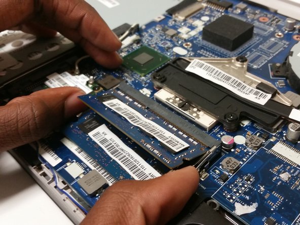

  16. Lenovo IdeaPad P400 Touch RAM Replacement, RAM: crwdns2935265:016crwdnd2935265:01crwdnd2935265:02crwdne2935265:0 Lenovo IdeaPad P400 Touch RAM Replacement, RAM: crwdns2935265:016crwdnd2935265:02crwdnd2935265:02crwdne2935265:0
    • Pull outward on both clips on the sides of the top RAM to release it.
    • The RAM will pop up slightly if you have pulled the clips out properly.
  17. Lenovo IdeaPad P400 Touch RAM Replacement: crwdns2935265:017crwdnd2935265:01crwdnd2935265:01crwdne2935265:0
    • Remove the top RAM from its slot by sliding it out.
  18. Lenovo IdeaPad P400 Touch RAM Replacement: crwdns2935265:018crwdnd2935265:01crwdnd2935265:02crwdne2935265:0 Lenovo IdeaPad P400 Touch RAM Replacement: crwdns2935265:018crwdnd2935265:02crwdnd2935265:02crwdne2935265:0

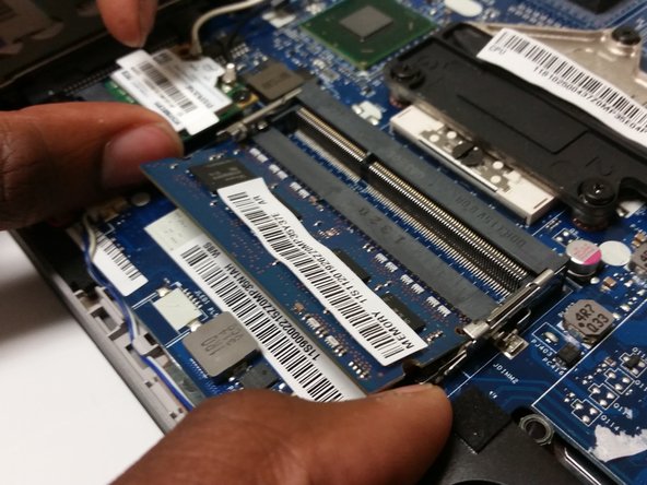

    • Pull outward on both clips on the sides of the bottom RAM to release it.
  19. Lenovo IdeaPad P400 Touch RAM Replacement: crwdns2935265:019crwdnd2935265:01crwdnd2935265:01crwdne2935265:0
    • Remove the bottom RAM from its slot by sliding it out.
