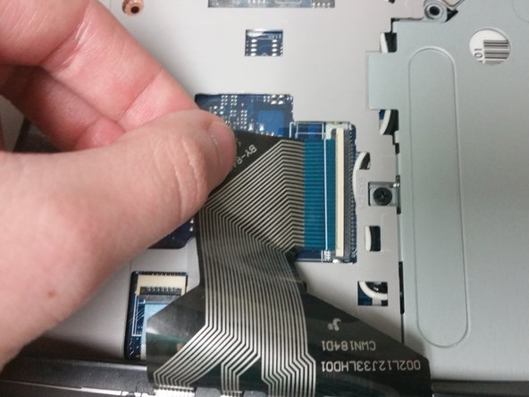

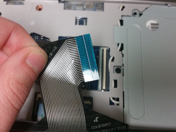

    • Lift the top of the keyboard and flip the keyboard face down so that you can access the connectors underneath it.
    • Using your fingers, unplug the large connector that connects the keyboard to the center of the laptop by sliding the end of the strip out of the socket.
    • You may need to flip the white plastic bar up with a fingernail to be able to remove the strip.

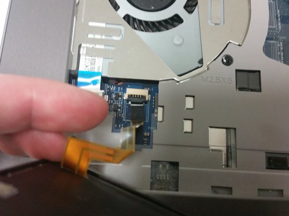

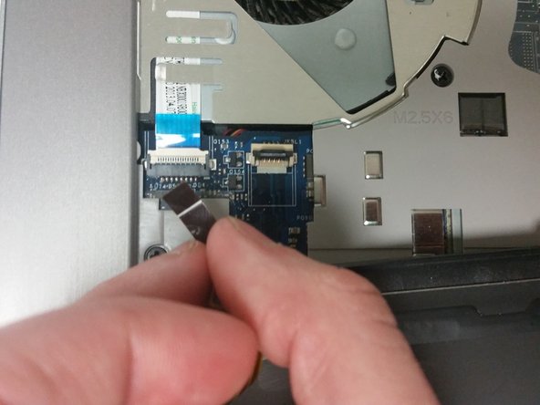

    • Using your fingers, unplug the second, smaller connector, located at the lower left hand side of the keyboard by sliding the strip out of the socket.
    • You may need to flip the white plastic bar up with your fingernail to remove the connector.
