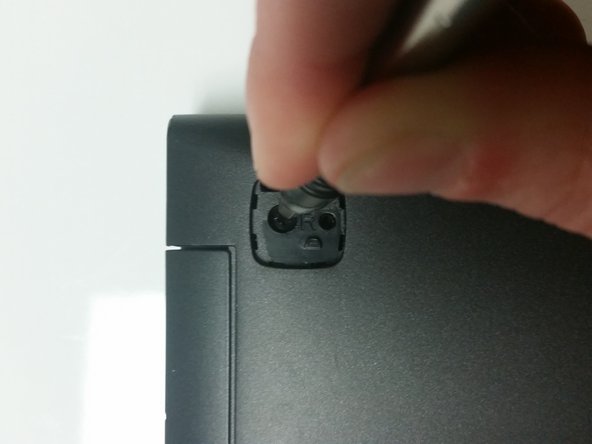

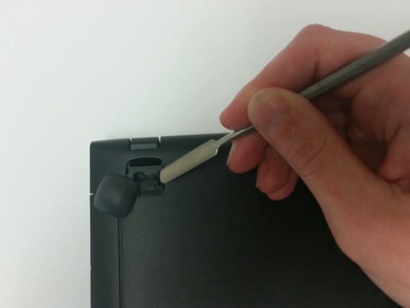

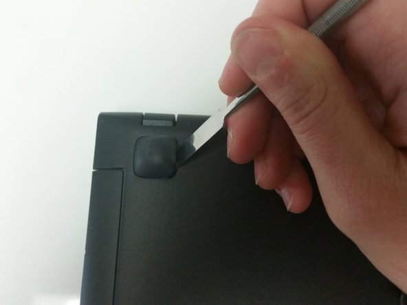

    • Using a spudger, remove the back two feet of the laptop.
    • You may need to use a metal spudger if you cannot remove them with a plastic one.

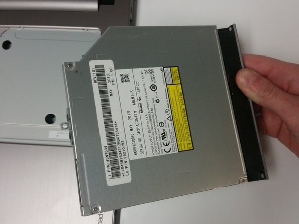

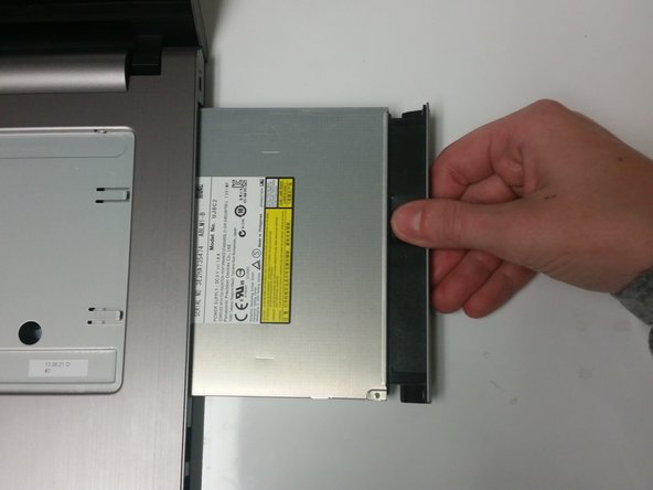

    • Flip the laptop over and open it.
    • Remove the 3mm Phillips #1 screw holding the disc drive in place.
    • Remove the disc drive by sliding it out.

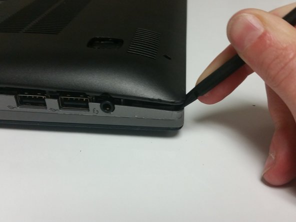

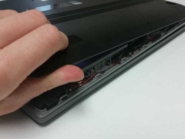

    • Using a plastic spudger, pry open the laptop case starting near the disc drive.
    • Continue prying open the case by using the spudger to open it in new areas.
    • Once there is enough space to allow you to grip the case, use your hands to finish removing it.
    • It may be difficult at first. If the plastic spudger does not work, you can try using a metal one. Using a hand to pull the case open while prying may help as well.

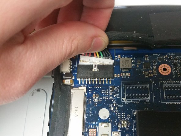

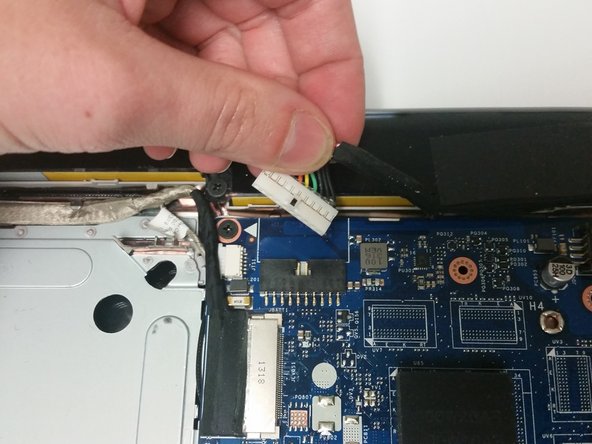

  13. Lenovo IdeaPad P400 Touch Battery Replacement: crwdns2935265:013crwdnd2935265:01crwdnd2935265:03crwdne2935265:0 Lenovo IdeaPad P400 Touch Battery Replacement: crwdns2935265:013crwdnd2935265:02crwdnd2935265:03crwdne2935265:0 Lenovo IdeaPad P400 Touch Battery Replacement: crwdns2935265:013crwdnd2935265:03crwdnd2935265:03crwdne2935265:0

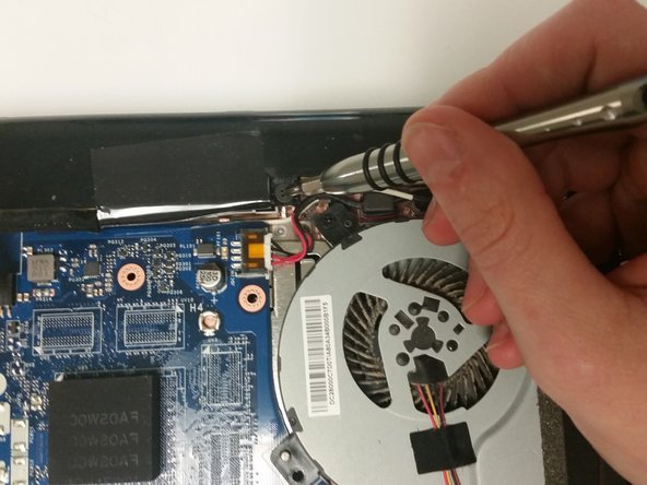

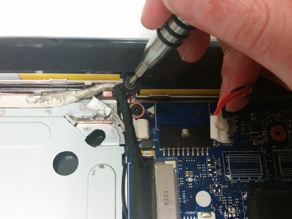

    • Using your fingers, unplug the battery from the laptop by taking the plug out of its socket.
  14. Lenovo IdeaPad P400 Touch Battery Replacement: crwdns2935265:014crwdnd2935265:01crwdnd2935265:03crwdne2935265:0 Lenovo IdeaPad P400 Touch Battery Replacement: crwdns2935265:014crwdnd2935265:02crwdnd2935265:03crwdne2935265:0 Lenovo IdeaPad P400 Touch Battery Replacement: crwdns2935265:014crwdnd2935265:03crwdnd2935265:03crwdne2935265:0
    • Unscrew the battery from the laptop by removing two 3mm Phillips #1 screws.

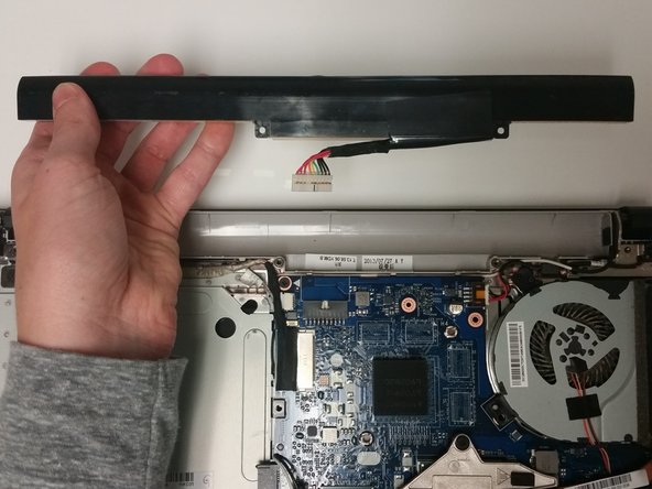

  15. Lenovo IdeaPad P400 Touch Battery Replacement: crwdns2935265:015crwdnd2935265:01crwdnd2935265:02crwdne2935265:0 Lenovo IdeaPad P400 Touch Battery Replacement: crwdns2935265:015crwdnd2935265:02crwdnd2935265:02crwdne2935265:0
    • Using your hand, remove the battery from the laptop by lifting one side and then pulling it out of its slot.
