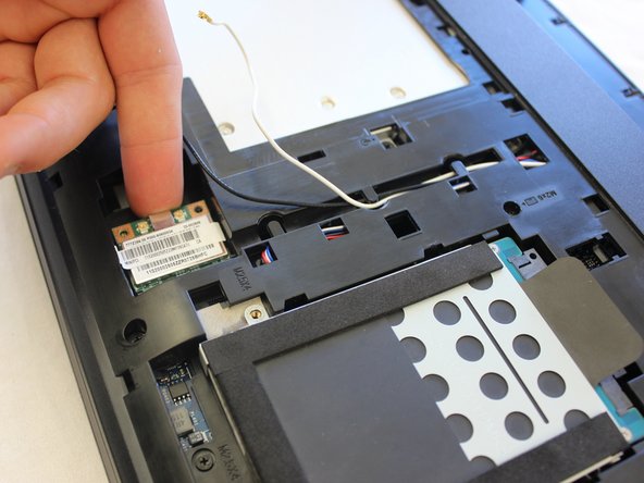

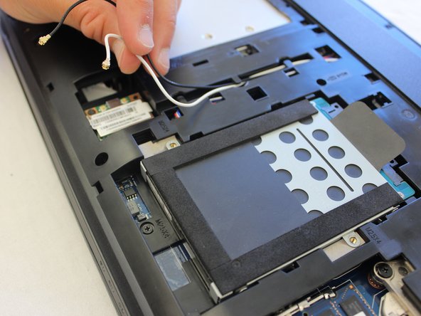

  9. Lenovo IdeaPad N586 Motherboard Replacement, Wifi card: crwdns2935265:09crwdnd2935265:01crwdnd2935265:02crwdne2935265:0 Lenovo IdeaPad N586 Motherboard Replacement, Wifi card: crwdns2935265:09crwdnd2935265:02crwdnd2935265:02crwdne2935265:0
    • Remove the white and black wires.
  10. Lenovo IdeaPad N586 Motherboard Replacement: crwdns2935265:010crwdnd2935265:01crwdnd2935265:02crwdne2935265:0 Lenovo IdeaPad N586 Motherboard Replacement: crwdns2935265:010crwdnd2935265:02crwdnd2935265:02crwdne2935265:0
    • Next, unscrew the wifi card
  11. Lenovo IdeaPad N586 Motherboard Replacement: crwdns2935265:011crwdnd2935265:01crwdnd2935265:01crwdne2935265:0
    • Pull out the wifi card.

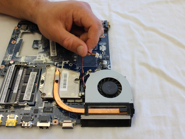

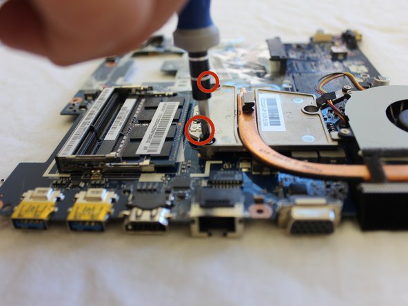

  18. Lenovo IdeaPad N586 Motherboard Replacement, Fan: crwdns2935265:018crwdnd2935265:01crwdnd2935265:02crwdne2935265:0 Lenovo IdeaPad N586 Motherboard Replacement, Fan: crwdns2935265:018crwdnd2935265:02crwdnd2935265:02crwdne2935265:0
    • Pull the plug shown.
  19. Lenovo IdeaPad N586 Motherboard Replacement: crwdns2935265:019crwdnd2935265:01crwdnd2935265:02crwdne2935265:0 Lenovo IdeaPad N586 Motherboard Replacement: crwdns2935265:019crwdnd2935265:02crwdnd2935265:02crwdne2935265:0
    • Lift up fan.
    • Remove two highlighted screws.
  20. Lenovo IdeaPad N586 Motherboard Replacement: crwdns2935265:020crwdnd2935265:01crwdnd2935265:01crwdne2935265:0
    • This is the fan separated from the motherboard.

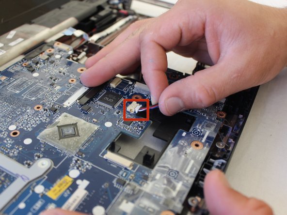

  25. Lenovo IdeaPad N586 Motherboard Replacement: crwdns2935265:025crwdnd2935265:01crwdnd2935265:02crwdne2935265:0 Lenovo IdeaPad N586 Motherboard Replacement: crwdns2935265:025crwdnd2935265:02crwdnd2935265:02crwdne2935265:0
    • Unplug highlighted tabs.

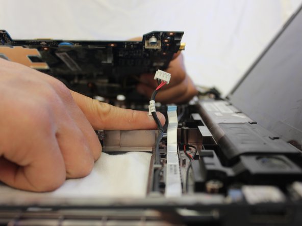

  26. Lenovo IdeaPad N586 Motherboard Replacement: crwdns2935265:026crwdnd2935265:01crwdnd2935265:02crwdne2935265:0 Lenovo IdeaPad N586 Motherboard Replacement: crwdns2935265:026crwdnd2935265:02crwdnd2935265:02crwdne2935265:0
    • More tabs need to be removed.
  27. Lenovo IdeaPad N586 Motherboard Replacement: crwdns2935265:027crwdnd2935265:01crwdnd2935265:02crwdne2935265:0 Lenovo IdeaPad N586 Motherboard Replacement: crwdns2935265:027crwdnd2935265:02crwdnd2935265:02crwdne2935265:0
    • Remove final plug connecting motherboard to base of laptop.
  28. Lenovo IdeaPad N586 Motherboard Replacement: crwdns2935265:028crwdnd2935265:01crwdnd2935265:01crwdne2935265:0
    • This is what the motherboard looks when taken out of the laptop.
