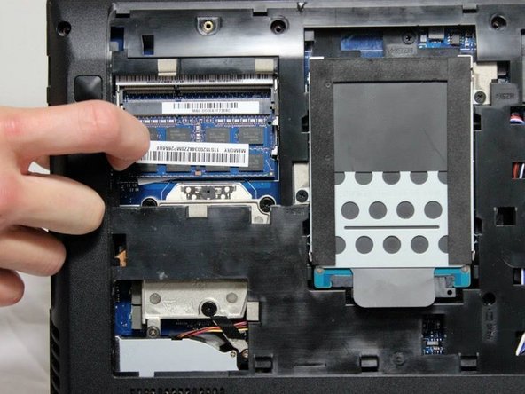

  5. Lenovo IdeaPad N586 Memory Replacement, Memory: crwdns2935265:05crwdnd2935265:01crwdnd2935265:02crwdne2935265:0 Lenovo IdeaPad N586 Memory Replacement, Memory: crwdns2935265:05crwdnd2935265:02crwdnd2935265:02crwdne2935265:0
    • Now push the little clips out away from the memory to unlock the memory.
  6. Lenovo IdeaPad N586 Memory Replacement: crwdns2935265:06crwdnd2935265:01crwdnd2935265:01crwdne2935265:0
    • After unlocking the memory from it's position, pull the memory out.
