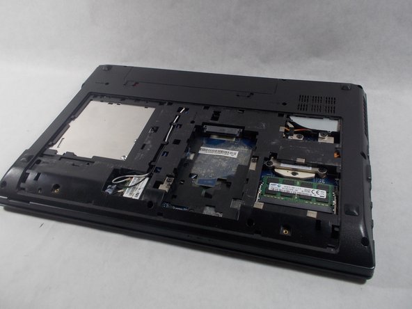

  5. Lenovo IdeaPad N580 RAM Replacement, RAM: crwdns2935265:05crwdnd2935265:01crwdnd2935265:01crwdne2935265:0
    • Rotate the laptop so that now the hinge is facing away from you.
    • Remove the two 2.5 x 4.0 mm Phillips #0 screws from the underside of the laptop.
  6. Lenovo IdeaPad N580 RAM Replacement: crwdns2935265:06crwdnd2935265:01crwdnd2935265:02crwdne2935265:0 Lenovo IdeaPad N580 RAM Replacement: crwdns2935265:06crwdnd2935265:02crwdnd2935265:02crwdne2935265:0
    • Slide the bottom panel towards you until it stops, and then carefully lift it off.

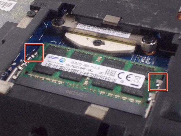

  7. Lenovo IdeaPad N580 RAM Replacement: crwdns2935265:07crwdnd2935265:01crwdnd2935265:03crwdne2935265:0 Lenovo IdeaPad N580 RAM Replacement: crwdns2935265:07crwdnd2935265:02crwdnd2935265:03crwdne2935265:0 Lenovo IdeaPad N580 RAM Replacement: crwdns2935265:07crwdnd2935265:03crwdnd2935265:03crwdne2935265:0
    • The RAM sticks can be found at the bottom right of the laptop.
    • Carefully press the two silver buttons on either side of the stick outwards. This will cause the RAM to “pop” up.
    • This device is capable of holding two RAM sticks, so there are two different sets of silver buttons; a top set and a bottom set. When removing the RAM stick, make sure to press either the two bottom buttons or the two top buttons.
  8. Lenovo IdeaPad N580 RAM Replacement: crwdns2935265:08crwdnd2935265:01crwdnd2935265:01crwdne2935265:0
    • Carefully slide the RAM straight out of its socket.
