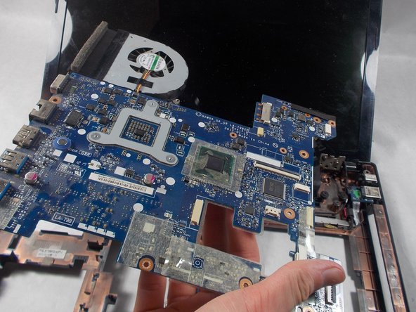

  12. Lenovo IdeaPad N580 Motherboard Replacement, Motherboard: crwdns2935265:012crwdnd2935265:01crwdnd2935265:01crwdne2935265:0
    • Remove the five ribbon cables on the top of the computer.
    • Gently remove the single cable from its socket.
  13. Lenovo IdeaPad N580 Motherboard Replacement: crwdns2935265:013crwdnd2935265:01crwdnd2935265:01crwdne2935265:0
    • Remove the three 2.5 x 3.0 mm Phillips #0 screws on the motherboard.
  14. Lenovo IdeaPad N580 Motherboard Replacement: crwdns2935265:014crwdnd2935265:01crwdnd2935265:02crwdne2935265:0 Lenovo IdeaPad N580 Motherboard Replacement: crwdns2935265:014crwdnd2935265:02crwdnd2935265:02crwdne2935265:0
    • Using your fingers or a spudger, lift the motherboard slightly.
    • Detach the single cable from underneath.
    • Lift the motherboard the rest of the way out.
