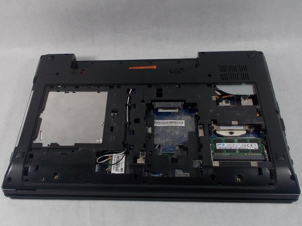

    • Rotate the laptop so that now the hinge is facing away from you.
    • Remove the two 2.5 x 4.0 mm Phillips #0 screws from the underside of the laptop.
    • Slide the bottom panel towards you until it stops, and then carefully lift it off.

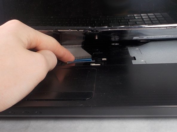

    • Turn the laptop right side up and open the lid.
    • Using the spudger and your fingers, get in between the keyboard's edge and lift it up.
    • Carefully lift the keyboard ribbon cable out of the socket it is in.

  9. Lenovo IdeaPad N580 Keyboard and Trackpad Replacement: crwdns2935265:09crwdnd2935265:01crwdnd2935265:01crwdne2935265:0
    • If a hard disk drive is installed, remove the two 2.5 x 4.0 mm Phillips #0 screws.
    • Slide the hard disk drive out of its socket.
  10. Lenovo IdeaPad N580 Keyboard and Trackpad Replacement: crwdns2935265:010crwdnd2935265:01crwdnd2935265:01crwdne2935265:0
    • Remove the eleven 2.5 x 6.0 mm Phillips #0 screws.
    • Remove the three 2.0 x 3.0 mm flat head screws.
    • Remove the 2.5 x 4.0 mm Phillips #0 screw.

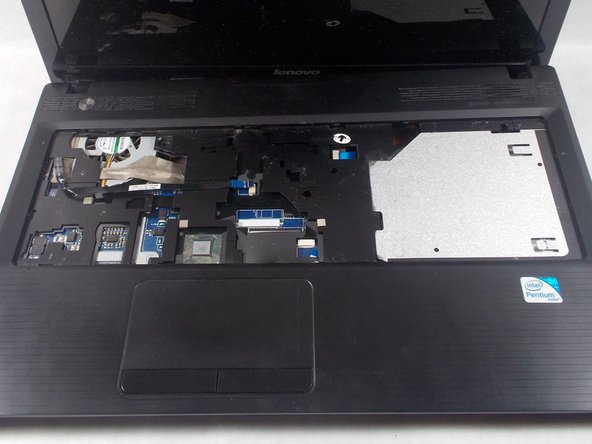

  11. Lenovo IdeaPad N580 Keyboard and Trackpad Replacement: crwdns2935265:011crwdnd2935265:01crwdnd2935265:02crwdne2935265:0 Lenovo IdeaPad N580 Keyboard and Trackpad Replacement: crwdns2935265:011crwdnd2935265:02crwdnd2935265:02crwdne2935265:0
    • Disconnect the two ribbon cables from the center.
    • Lift the keyboard bezel (with trackpad) straight up and out.
