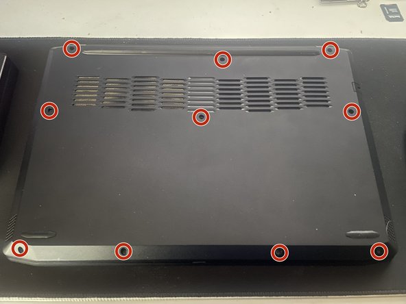

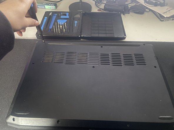

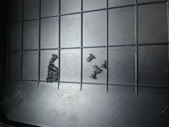

    • First of all unplug the laptop from power and turn it off.
    • Then using an Phillips screwdriver remove the 10 screws from the back of the computer
    • Separate the screws as the 4 on the bottom are a different size than the rest

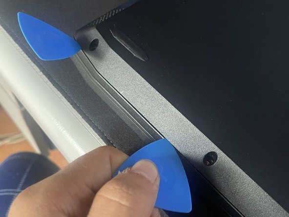

  2. Lenovo IdeaPad Gaming 3 15ARH-334 RAM Replacement, Opening Part 2: crwdns2935265:02crwdnd2935265:01crwdnd2935265:03crwdne2935265:0 Lenovo IdeaPad Gaming 3 15ARH-334 RAM Replacement, Opening Part 2: crwdns2935265:02crwdnd2935265:02crwdnd2935265:03crwdne2935265:0 Lenovo IdeaPad Gaming 3 15ARH-334 RAM Replacement, Opening Part 2: crwdns2935265:02crwdnd2935265:03crwdnd2935265:03crwdne2935265:0

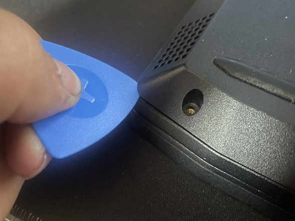

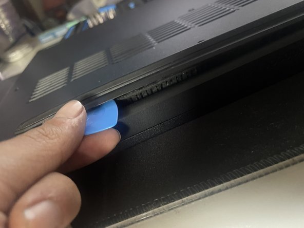

    • Using an openning pick or just any credit card or something like it try to open get an openning. In this case going at an almost 45º angle on the corners or the back side proved the easiest for me.
    • The first time you open the laptop may be harder and you may need to try it a few times. But don't give up and be gentle!
    • After you have an openning using another openning pick or the same slide along the borders until the back pannel is loose and then remove it

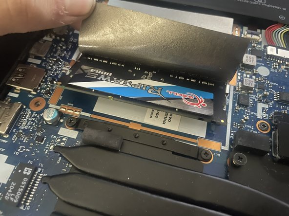

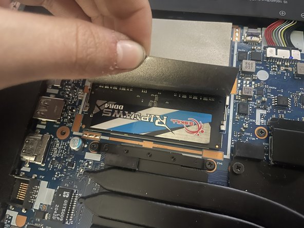

  3. Lenovo IdeaPad Gaming 3 15ARH-334 RAM Replacement, Finding the RAM: crwdns2935265:03crwdnd2935265:01crwdnd2935265:02crwdne2935265:0 Lenovo IdeaPad Gaming 3 15ARH-334 RAM Replacement, Finding the RAM: crwdns2935265:03crwdnd2935265:02crwdnd2935265:02crwdne2935265:0

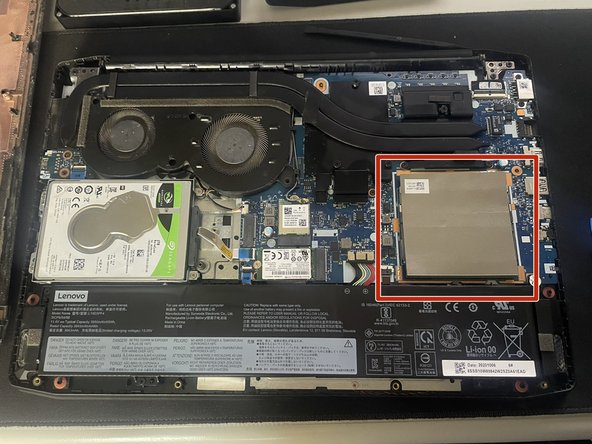

    • When you open the laptop you'll be able to see what makes all the magic possible and also a grey square where the RAM sticks hide.
    • Pull the tape up, without using much force, and you'll have access to the RAM sticks. If you are upgrading and you only have 1 stick, perfect move on to step 5 otherwise on to the next step you go.

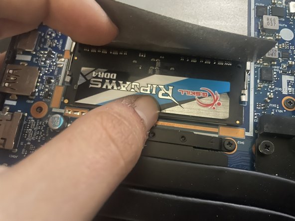

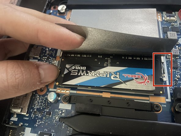

  4. Lenovo IdeaPad Gaming 3 15ARH-334 RAM Replacement, Removing the old RAM: crwdns2935265:04crwdnd2935265:01crwdnd2935265:02crwdne2935265:0 Lenovo IdeaPad Gaming 3 15ARH-334 RAM Replacement, Removing the old RAM: crwdns2935265:04crwdnd2935265:02crwdnd2935265:02crwdne2935265:0
    • To remove the RAM you'll have to open the retaining latches. Using your finger just push it to the side and after you do it on both sides the ram just pops up and you can remove it.
    • If the RAM popping up scares you or you think you just broke it, don't worry it's normal and it also happened to me at first

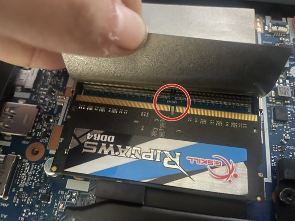

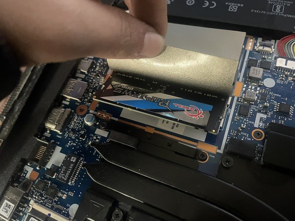

  5. Lenovo IdeaPad Gaming 3 15ARH-334 RAM Replacement, Inserting a new RAM stick: crwdns2935265:05crwdnd2935265:01crwdnd2935265:03crwdne2935265:0 Lenovo IdeaPad Gaming 3 15ARH-334 RAM Replacement, Inserting a new RAM stick: crwdns2935265:05crwdnd2935265:02crwdnd2935265:03crwdne2935265:0 Lenovo IdeaPad Gaming 3 15ARH-334 RAM Replacement, Inserting a new RAM stick: crwdns2935265:05crwdnd2935265:03crwdnd2935265:03crwdne2935265:0
    • To add a new RAM stick you have to first align the notch on the RAM with the one on the slot on the motherboard. After that insert it at an angle like it was when the other one popped up and just push it down nice and easy as well as the tape
    • At this point you may want to put the cover on without closing it all the way, turn the pc on and see if the RAM is registred.
To finish it all off put the cover on, making sure you push it down so it clicks and is properly closed, add the screws again and you're done.
