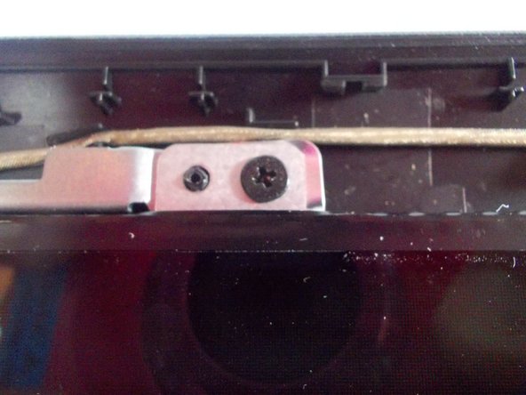

    • Remove the bezel by using the iFixit plastic opening tool to lift up an edge.
    • The bezel is the plastic lining along the edge of the screen.
  2. Lenovo IdeaPad G50-45 Screen Replacement: crwdns2935265:02crwdnd2935265:01crwdnd2935265:01crwdne2935265:0
    • Finish removing the bezel by using your hand on the inside of the screen and popping it off.
    • If part of the bezel is stuck, start on the opposite side and work your way back to the area that is stuck.
    • The plastic on the hinges will pop off with the rest of the bezel.

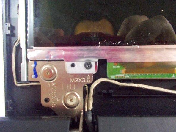

  3. Lenovo IdeaPad G50-45 Screen Replacement: crwdns2935265:03crwdnd2935265:01crwdnd2935265:03crwdne2935265:0 Lenovo IdeaPad G50-45 Screen Replacement: crwdns2935265:03crwdnd2935265:02crwdnd2935265:03crwdne2935265:0 Lenovo IdeaPad G50-45 Screen Replacement: crwdns2935265:03crwdnd2935265:03crwdnd2935265:03crwdne2935265:0
    • Remove the 4 screws located in each corner of the screen using the Phillips #2 screwdriver.

The tutorial was pretty straightforward, and worked.
