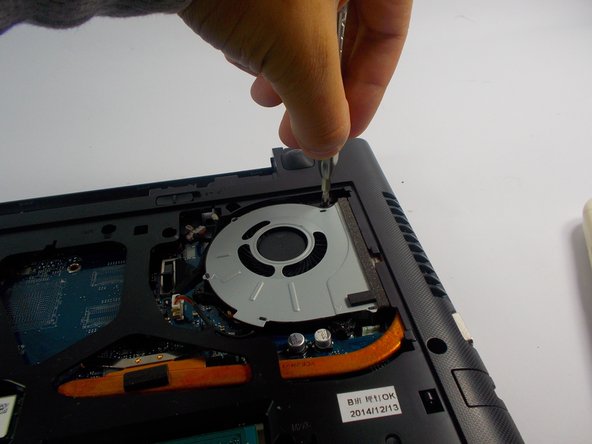

    • Safely flip the device upside down and use the Phillips head screwdriver to remove the 3 screws at the bottom of the device which are circled.
  2. Lenovo IdeaPad G50-45 Fan Replacement: crwdns2935265:02crwdnd2935265:01crwdnd2935265:01crwdne2935265:0
    • Slide, do not lift, the bottom panel off once the 3 screws are off.
  3. Lenovo IdeaPad G50-45 Fan Replacement: crwdns2935265:03crwdnd2935265:01crwdnd2935265:01crwdne2935265:0
    • Locate the fan in the upper right corner above the orange bar and appears as a silver semicircle.
  4. Lenovo IdeaPad G50-45 Fan Replacement: crwdns2935265:04crwdnd2935265:01crwdnd2935265:02crwdne2935265:0 Lenovo IdeaPad G50-45 Fan Replacement: crwdns2935265:04crwdnd2935265:02crwdnd2935265:02crwdne2935265:0
    • Remove the 3 screws attaching the fan to the device.
  5. Lenovo IdeaPad G50-45 Fan Replacement: crwdns2935265:05crwdnd2935265:01crwdnd2935265:01crwdne2935265:0
    • Once the screws are removed slowly lift the fan out, there will be a thin wire connected to the device and fan still, Firmly grasp the white end of the wire where the wire splits into 2 and pull it out.
  6. Lenovo IdeaPad G50-45 Fan Replacement: crwdns2935265:06crwdnd2935265:01crwdnd2935265:01crwdne2935265:0
    • The fan should be removed now and appear as so.
