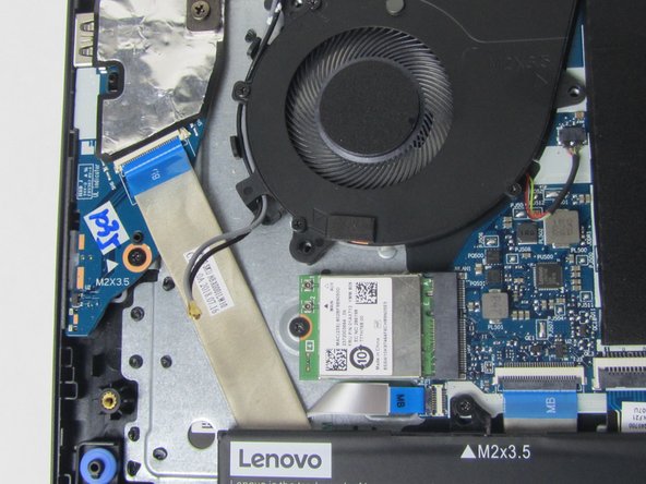

  3. Lenovo IdeaPad Flex 6-14IKB Wi-Fi Card Replacement, Wi-Fi Card: crwdns2935265:03crwdnd2935265:01crwdnd2935265:02crwdne2935265:0 Lenovo IdeaPad Flex 6-14IKB Wi-Fi Card Replacement, Wi-Fi Card: crwdns2935265:03crwdnd2935265:02crwdnd2935265:02crwdne2935265:0
    • Detach the gray and black wires from the Wi-Fi card.

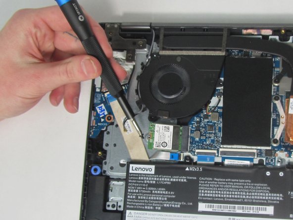

  4. Lenovo IdeaPad Flex 6-14IKB Wi-Fi Card Replacement: crwdns2935265:04crwdnd2935265:01crwdnd2935265:02crwdne2935265:0 Lenovo IdeaPad Flex 6-14IKB Wi-Fi Card Replacement: crwdns2935265:04crwdnd2935265:02crwdnd2935265:02crwdne2935265:0
    • Remove the single 3.5 mm screw that secures the Wi-Fi card using a Phillips #00 screwdriver.

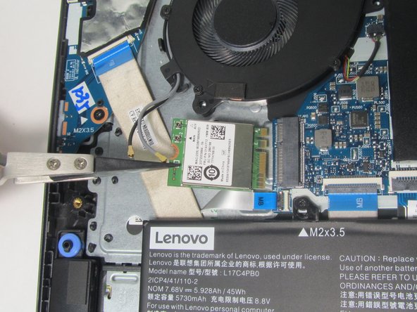

  5. Lenovo IdeaPad Flex 6-14IKB Wi-Fi Card Replacement: crwdns2935265:05crwdnd2935265:01crwdnd2935265:02crwdne2935265:0 Lenovo IdeaPad Flex 6-14IKB Wi-Fi Card Replacement: crwdns2935265:05crwdnd2935265:02crwdnd2935265:02crwdne2935265:0
    • Remove the Wi-Fi card from its slot using tweezers.
    • When reinstalling, the gray wire goes into the connector labeled number 1. The black wire goes into the connector labeled number 2. You will hear an audible click when it is properly clipped back into place.
