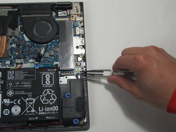

  3. Lenovo IdeaPad Flex 6-14IKB Speakers Replacement, Speakers: crwdns2935265:03crwdnd2935265:01crwdnd2935265:02crwdne2935265:0 Lenovo IdeaPad Flex 6-14IKB Speakers Replacement, Speakers: crwdns2935265:03crwdnd2935265:02crwdnd2935265:02crwdne2935265:0
    • Unplug the wire connector from the speaker using the tweezers.

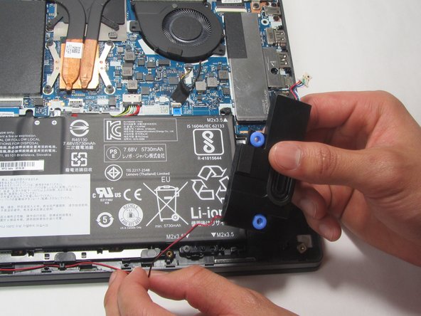

  4. Lenovo IdeaPad Flex 6-14IKB Speakers Replacement: crwdns2935265:04crwdnd2935265:01crwdnd2935265:02crwdne2935265:0 Lenovo IdeaPad Flex 6-14IKB Speakers Replacement: crwdns2935265:04crwdnd2935265:02crwdnd2935265:02crwdne2935265:0
    • Lift the right side speaker off of the pins that the speaker is resting on using an iFixit opening tool.
  5. Lenovo IdeaPad Flex 6-14IKB Speakers Replacement: crwdns2935265:05crwdnd2935265:01crwdnd2935265:01crwdne2935265:0
    • Unwind the red and black wire that connects the two speakers from the plastic clips that secure it.
  6. Lenovo IdeaPad Flex 6-14IKB Speakers Replacement: crwdns2935265:06crwdnd2935265:01crwdnd2935265:01crwdne2935265:0
    • Lift the left side speaker off of the pins that the speaker is resting on using an iFixit opening tool.
