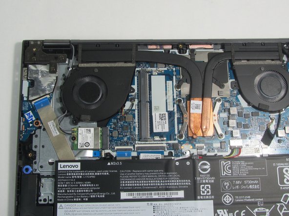

  1. Lenovo IdeaPad Flex 6-14IKB RAM Replacement, Base Cover: crwdns2935265:01crwdnd2935265:01crwdnd2935265:01crwdne2935265:0
    • Remove the ten 6.5 mm screws that secure the base cover using a T5 Torx screwdriver.

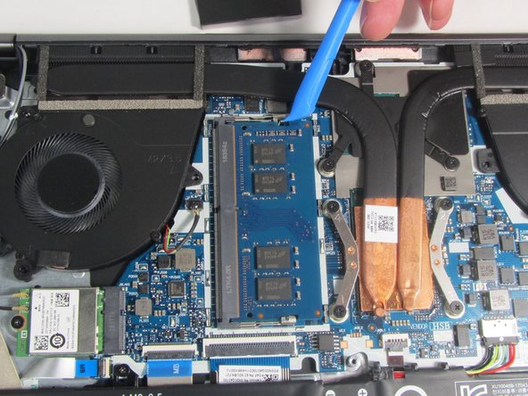

  3. Lenovo IdeaPad Flex 6-14IKB RAM Replacement, RAM: crwdns2935265:03crwdnd2935265:01crwdnd2935265:01crwdne2935265:0
    • Use the plastic opening tool to pry the protective cover off of the RAM.

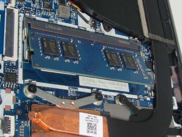

  4. Lenovo IdeaPad Flex 6-14IKB RAM Replacement: crwdns2935265:04crwdnd2935265:01crwdnd2935265:02crwdne2935265:0 Lenovo IdeaPad Flex 6-14IKB RAM Replacement: crwdns2935265:04crwdnd2935265:02crwdnd2935265:02crwdne2935265:0
    • Unfasten the metal clips that secure the RAM.
  5. Lenovo IdeaPad Flex 6-14IKB RAM Replacement: crwdns2935265:05crwdnd2935265:01crwdnd2935265:03crwdne2935265:0 Lenovo IdeaPad Flex 6-14IKB RAM Replacement: crwdns2935265:05crwdnd2935265:02crwdnd2935265:03crwdne2935265:0 Lenovo IdeaPad Flex 6-14IKB RAM Replacement: crwdns2935265:05crwdnd2935265:03crwdnd2935265:03crwdne2935265:0
    • Remove the RAM from its slot on the motherboard.
