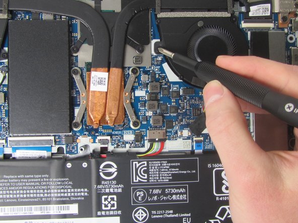

    • Remove the six 3.5 mm screws that secure the fans in place using a Phillips #00 screwdriver.
    • Loosen the seven captive screws using a Phillips #00 screwdriver.

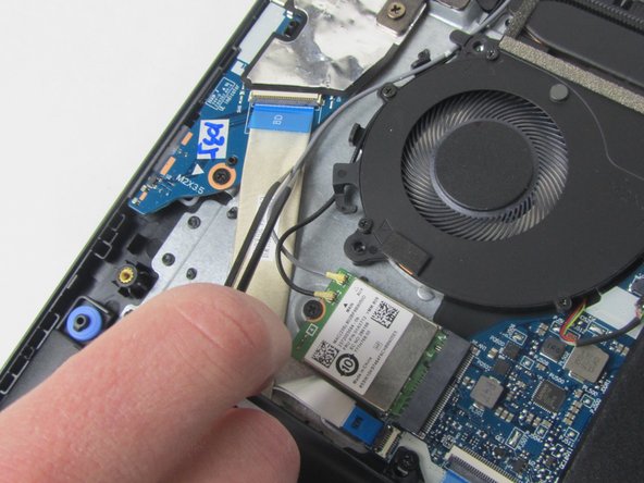

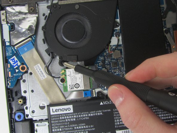

    • Use tweezers to unwind the black and gray wires from the clips that are holding them onto the left side fan.

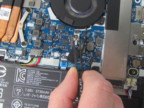

    • Lift the black piece of cloth tape that secures the right side fan wires to the circuit board.
  6. Lenovo IdeaPad Flex 6-14IKB Cooling Fans Replacement: crwdns2935265:06crwdnd2935265:01crwdnd2935265:03crwdne2935265:0 Lenovo IdeaPad Flex 6-14IKB Cooling Fans Replacement: crwdns2935265:06crwdnd2935265:02crwdnd2935265:03crwdne2935265:0 Lenovo IdeaPad Flex 6-14IKB Cooling Fans Replacement: crwdns2935265:06crwdnd2935265:03crwdnd2935265:03crwdne2935265:0
    • Use tweezers to unplug the wiring connectors that are connected to each fan.

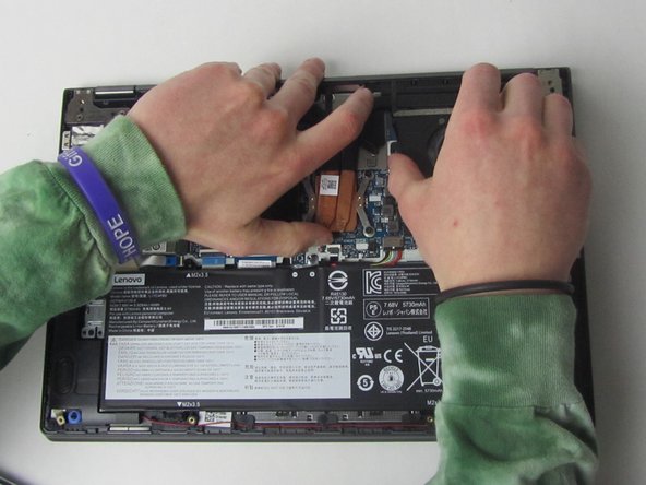

    • Gently remove the fans from the laptop.
    • There is thermal paste attaching the ducting of the fans that will require some careful prying.
    • When replacing the fan, reapply a pea sized amount of thermal paste to the fan ducts.
