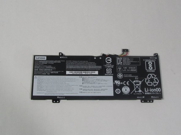

  3. Lenovo IdeaPad Flex 6-14IKB Battery Replacement, Battery: crwdns2935265:03crwdnd2935265:01crwdnd2935265:01crwdne2935265:0
    • Remove the four 3.5 mm screws around the battery using a Phillips #00 screwdriver.
  4. Lenovo IdeaPad Flex 6-14IKB Battery Replacement: crwdns2935265:04crwdnd2935265:01crwdnd2935265:02crwdne2935265:0 Lenovo IdeaPad Flex 6-14IKB Battery Replacement: crwdns2935265:04crwdnd2935265:02crwdnd2935265:02crwdne2935265:0
    • Disconnect the battery supply from the motherboard using a pair of tweezers.
    • Remove the battery from the laptop.
    • If the battery has an adhesive patch on the underside, gently pry off the battery.
