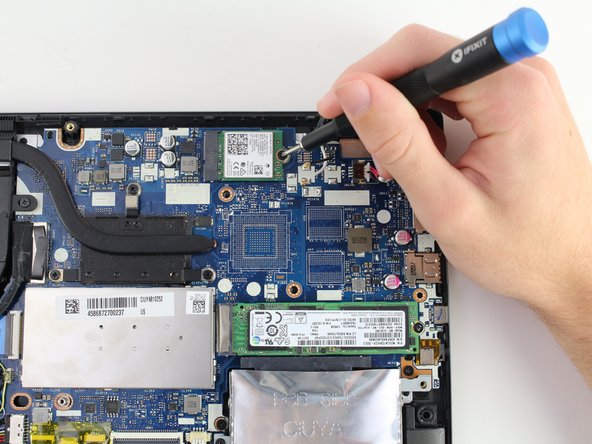

    • Remove all ten 6.6 mm screws with a Phillips #00 screwdriver.
  2. Lenovo IdeaPad Flex 5-1470 Wireless Network Adapter Replacement: crwdns2935265:02crwdnd2935265:01crwdnd2935265:02crwdne2935265:0 Lenovo IdeaPad Flex 5-1470 Wireless Network Adapter Replacement: crwdns2935265:02crwdnd2935265:02crwdnd2935265:02crwdne2935265:0
    • Use the plastic opening tool to lift up and remove the casing.
  3. Lenovo IdeaPad Flex 5-1470 Wireless Network Adapter Replacement, Wireless Network Adapter: crwdns2935265:03crwdnd2935265:01crwdnd2935265:02crwdne2935265:0 Lenovo IdeaPad Flex 5-1470 Wireless Network Adapter Replacement, Wireless Network Adapter: crwdns2935265:03crwdnd2935265:02crwdnd2935265:02crwdne2935265:0
    • Use the reverse tweezers to carefully unplug the two wired connections.
    • Be careful when removing the wire connections to avoid damage to the metal connections on the adapter.
  4. Lenovo IdeaPad Flex 5-1470 Wireless Network Adapter Replacement: crwdns2935265:04crwdnd2935265:01crwdnd2935265:02crwdne2935265:0 Lenovo IdeaPad Flex 5-1470 Wireless Network Adapter Replacement: crwdns2935265:04crwdnd2935265:02crwdnd2935265:02crwdne2935265:0
    • Using the Phillips #00 screwdriver, remove one 3.6 mm screw.
  5. Lenovo IdeaPad Flex 5-1470 Wireless Network Adapter Replacement: crwdns2935265:05crwdnd2935265:01crwdnd2935265:01crwdne2935265:0
    • Remove the wireless network adapter.

My problem now is the replacement of the tiny male connectors which hooks onto the chip. They are shown in the last image above at the end of the white wire!
I do not know where to get them, given that mine were broken off.
I would deeply appreciate your help in identifying this type of connectors and locating a sources!
