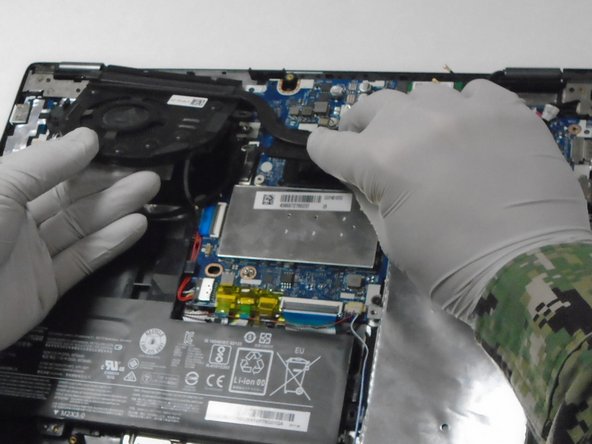

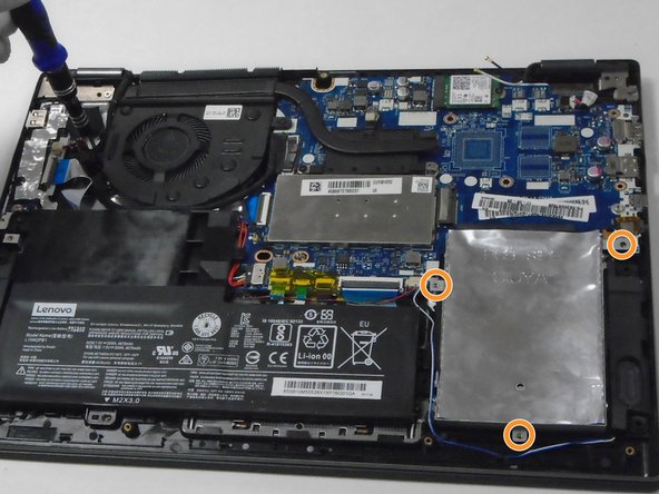

  4. Lenovo IdeaPad Flex 5-1470 Motherboard Replacement, Motherboard: crwdns2935265:04crwdnd2935265:01crwdnd2935265:03crwdne2935265:0 Lenovo IdeaPad Flex 5-1470 Motherboard Replacement, Motherboard: crwdns2935265:04crwdnd2935265:02crwdnd2935265:03crwdne2935265:0 Lenovo IdeaPad Flex 5-1470 Motherboard Replacement, Motherboard: crwdns2935265:04crwdnd2935265:03crwdnd2935265:03crwdne2935265:0
    • Use a Phillips #00 screwdriver to remove the three screws securing the fan.
    • Lift the fan up and out.
    • Use a Phillips #00 screwdriver to remove the three screws securing the hard drive.
    • Lift the hard drive up and out.

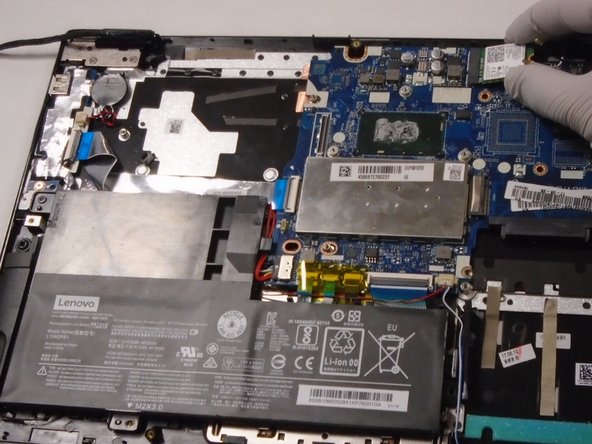

  5. Lenovo IdeaPad Flex 5-1470 Motherboard Replacement: crwdns2935265:05crwdnd2935265:01crwdnd2935265:02crwdne2935265:0 Lenovo IdeaPad Flex 5-1470 Motherboard Replacement: crwdns2935265:05crwdnd2935265:02crwdnd2935265:02crwdne2935265:0
    • Use a Phillips #00 screwdriver to remove the single screw securing the Wi-Fi card.
    • The Wi-Fi card will slightly lift away from the motherboard.
    • Pull the Wi-Fi card directly out of its port.

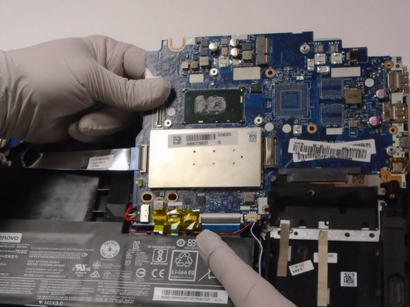

  6. Lenovo IdeaPad Flex 5-1470 Motherboard Replacement: crwdns2935265:06crwdnd2935265:01crwdnd2935265:02crwdne2935265:0 Lenovo IdeaPad Flex 5-1470 Motherboard Replacement: crwdns2935265:06crwdnd2935265:02crwdnd2935265:02crwdne2935265:0
    • Use a Phillips #00 screwdriver to remove the three screws securing the motherboard.
    • Gently disconnect the cables and ribbon cables connected to the motherboard.
