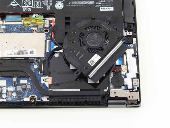

    • Remove all ten 6.6 mm screws with a Phillips #00 screwdriver.
  2. Lenovo IdeaPad Flex 5-1470 Fan Replacement: crwdns2935265:02crwdnd2935265:01crwdnd2935265:02crwdne2935265:0 Lenovo IdeaPad Flex 5-1470 Fan Replacement: crwdns2935265:02crwdnd2935265:02crwdnd2935265:02crwdne2935265:0
    • Use the plastic opening tool to lift up and remove the casing.
  3. Lenovo IdeaPad Flex 5-1470 Fan Replacement, Fan: crwdns2935265:03crwdnd2935265:01crwdnd2935265:02crwdne2935265:0 Lenovo IdeaPad Flex 5-1470 Fan Replacement, Fan: crwdns2935265:03crwdnd2935265:02crwdnd2935265:02crwdne2935265:0
    • Remove the two 3.6 mm fan screws located in the top left corner of the device.
  4. Lenovo IdeaPad Flex 5-1470 Fan Replacement: crwdns2935265:04crwdnd2935265:01crwdnd2935265:01crwdne2935265:0
    • Find the black cable connecting the fan to the motherboard and gently unplug the cable to fully remove the fan.
