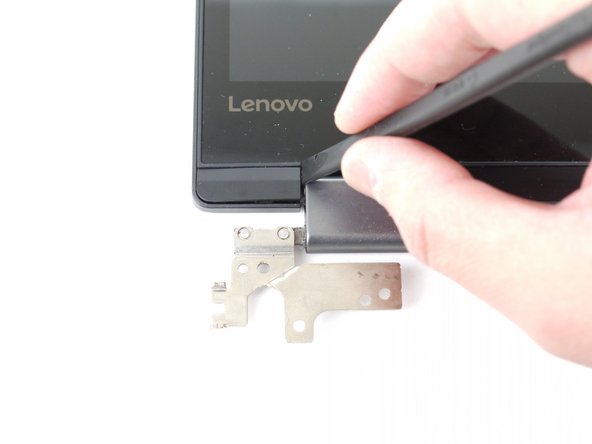

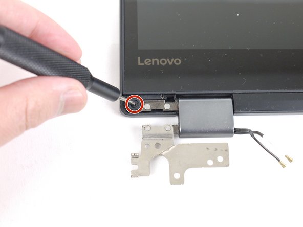

  6. Lenovo IdeaPad Flex 5-1470 Display Replacement, Display: crwdns2935265:06crwdnd2935265:01crwdnd2935265:01crwdne2935265:0
    • Use a Phillips #00 screwdriver to remove the four 5 mm screws from the left and right hinges (two screws on each hinge).
  7. Lenovo IdeaPad Flex 5-1470 Display Replacement: crwdns2935265:07crwdnd2935265:01crwdnd2935265:03crwdne2935265:0 Lenovo IdeaPad Flex 5-1470 Display Replacement: crwdns2935265:07crwdnd2935265:02crwdnd2935265:03crwdne2935265:0 Lenovo IdeaPad Flex 5-1470 Display Replacement: crwdns2935265:07crwdnd2935265:03crwdnd2935265:03crwdne2935265:0
    • Disconnect the display assembly from the rest of the device by separating the hinges of the display from the body of the laptop.
    • Use a spudger to carefully pry loose the two screw covers (one on each hinge).
    • Use a Phillips #00 screwdriver to remove the two 3 mm screws from the display (one on each side).

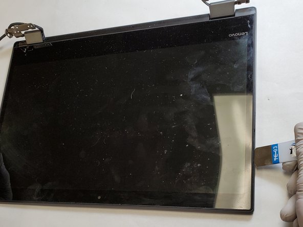

  8. Lenovo IdeaPad Flex 5-1470 Display Replacement: crwdns2935265:08crwdnd2935265:01crwdnd2935265:02crwdne2935265:0 Lenovo IdeaPad Flex 5-1470 Display Replacement: crwdns2935265:08crwdnd2935265:02crwdnd2935265:02crwdne2935265:0
    • Use a heat gun or an iOpener to lightly heat the outer edges of the display, loosening the adhesive strips.
    • Wedge a Jimmy or opening picks between the display and display housing, then carefully pry around the entire perimeter until the display separates from the housing.
  9. Lenovo IdeaPad Flex 5-1470 Display Replacement: crwdns2935265:09crwdnd2935265:01crwdnd2935265:01crwdne2935265:0
    • Disconnect the display ribbon cable.

Step 7: You got the screws under the edges of the lower bezel but not the ones in the middle. You need to remove those as well. Underneath the middle bezel is where you get access to the adhesive holding the screws in. Removing the adhesive this way makes it easy to remove the LCD and not have to use heat which can damage it.
John Doe - crwdns2934203:0crwdne2934203:0
Oh and you also need to remove the little rubber covers from the inside edges of the hinges so that you can remove the lcd cable and wifi antenna cables
