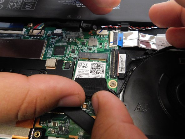

  2. Lenovo IdeaPad Flex 5 Chrome 13ITL6 Wi-Fi Card Replacement: crwdns2935265:02crwdnd2935265:01crwdnd2935265:03crwdne2935265:0 Lenovo IdeaPad Flex 5 Chrome 13ITL6 Wi-Fi Card Replacement: crwdns2935265:02crwdnd2935265:02crwdnd2935265:03crwdne2935265:0 Lenovo IdeaPad Flex 5 Chrome 13ITL6 Wi-Fi Card Replacement: crwdns2935265:02crwdnd2935265:03crwdnd2935265:03crwdne2935265:0
    • Locate the Wi-Fi card. For this device, it can be seen next to the fan.
    • Lift up the black tape to expose the cables, and gently disconnect them.

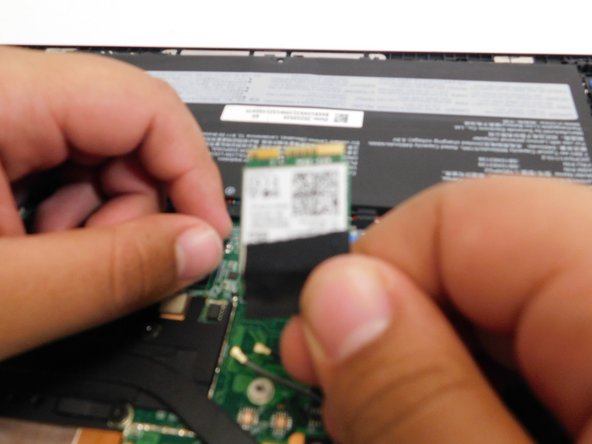

  3. Lenovo IdeaPad Flex 5 Chrome 13ITL6 Wi-Fi Card Replacement: crwdns2935265:03crwdnd2935265:01crwdnd2935265:03crwdne2935265:0 Lenovo IdeaPad Flex 5 Chrome 13ITL6 Wi-Fi Card Replacement: crwdns2935265:03crwdnd2935265:02crwdnd2935265:03crwdne2935265:0 Lenovo IdeaPad Flex 5 Chrome 13ITL6 Wi-Fi Card Replacement: crwdns2935265:03crwdnd2935265:03crwdnd2935265:03crwdne2935265:0
    • Use a Phillips #00 screwdriver to remove the screw that secure the Wi-Fi card.
    • To remove the card, lift up and pull.
