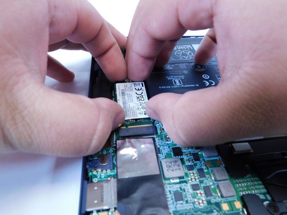

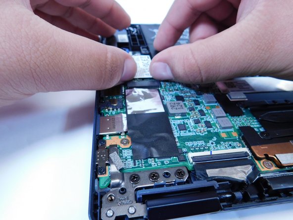

    • Remove the Phillips #00 screw.
    • To remove the SSD, lift where it was screwed in and gently pull it free.
