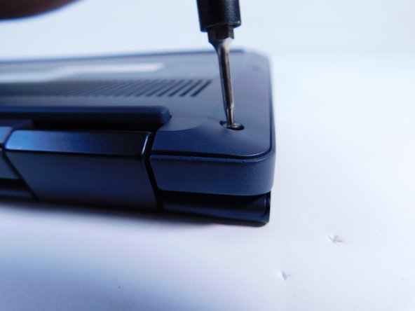

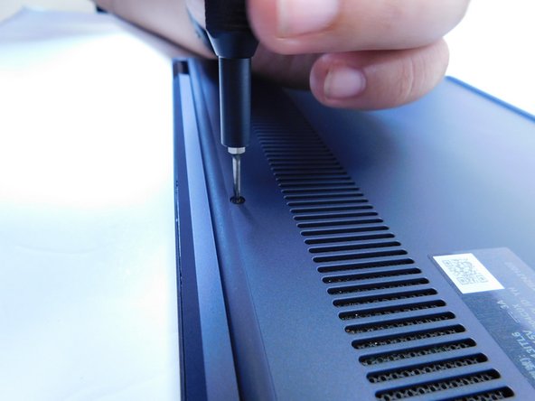

    • Orient the laptop so that the underside is facing up.
    • Use a T5 Torx screwdriver to remove the nine 6.3 mm screws that secure the lower case.

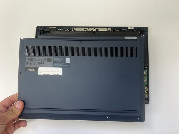

    • Wedge three opening picks into the seam between the back panel and the laptop: One in the bottom edge and one on either side of the laptop.
    • Slide the picks around the perimeter until the lower case fully releases.
    • Remove the lower case.
