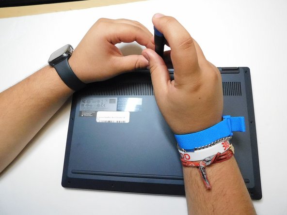

  2. Lenovo IdeaPad Flex 5 Chrome 13ITL6 Battery Replacement: crwdns2935265:02crwdnd2935265:01crwdnd2935265:03crwdne2935265:0 Lenovo IdeaPad Flex 5 Chrome 13ITL6 Battery Replacement: crwdns2935265:02crwdnd2935265:02crwdnd2935265:03crwdne2935265:0 Lenovo IdeaPad Flex 5 Chrome 13ITL6 Battery Replacement: crwdns2935265:02crwdnd2935265:03crwdnd2935265:03crwdne2935265:0
    • Flip the computer over.
    • Unscrew the 9 case screws with the T5 screwdriver.
  3. Lenovo IdeaPad Flex 5 Chrome 13ITL6 Battery Replacement: crwdns2935265:03crwdnd2935265:01crwdnd2935265:01crwdne2935265:0
    • Open the back of the device this will require some pressure it is recommended to use the opening tool for this task.

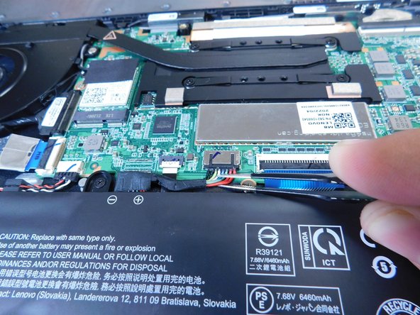

  4. Lenovo IdeaPad Flex 5 Chrome 13ITL6 Battery Replacement: crwdns2935265:04crwdnd2935265:01crwdnd2935265:02crwdne2935265:0 Lenovo IdeaPad Flex 5 Chrome 13ITL6 Battery Replacement: crwdns2935265:04crwdnd2935265:02crwdnd2935265:02crwdne2935265:0
    • Disconnect the 8 cable pin that is connected to the battery.

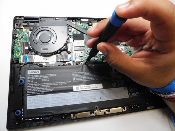

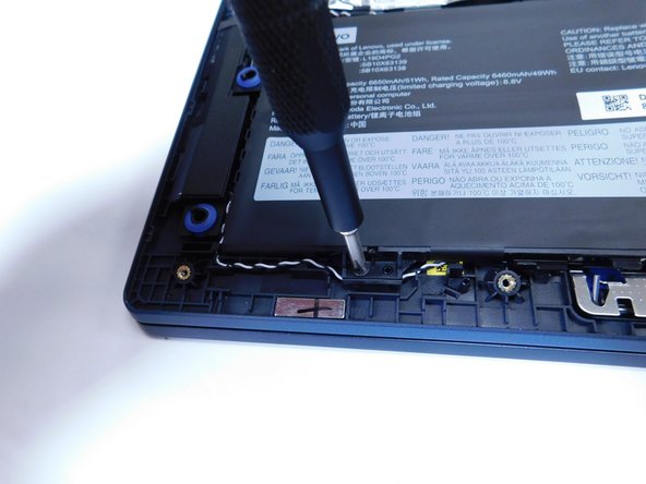

  5. Lenovo IdeaPad Flex 5 Chrome 13ITL6 Battery Replacement: crwdns2935265:05crwdnd2935265:01crwdnd2935265:02crwdne2935265:0 Lenovo IdeaPad Flex 5 Chrome 13ITL6 Battery Replacement: crwdns2935265:05crwdnd2935265:02crwdnd2935265:02crwdne2935265:0
    • Remove the 5 screws that secure the battery using the Phillips #0 screwdriver.
