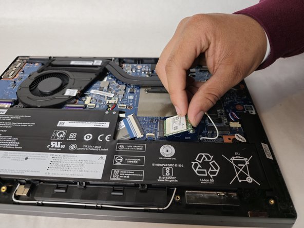

  4. Lenovo IdeaPad Flex 5 14ARE05 Wi-Fi Card Replacement, Wi-Fi Card: crwdns2935265:04crwdnd2935265:01crwdnd2935265:02crwdne2935265:0 Lenovo IdeaPad Flex 5 14ARE05 Wi-Fi Card Replacement, Wi-Fi Card: crwdns2935265:04crwdnd2935265:02crwdnd2935265:02crwdne2935265:0
    • Remove the 2 mm screw using a Phillips #2 screwdriver.
    • Disconnect the white and black wires.
    • Carefully lift upward where the screw was on the Wi-Fi card.
    • Be careful not to rip the wires from the motherboard, or bend the NVMe slot.
