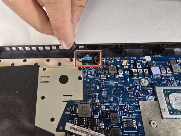

  8. Lenovo IdeaPad Flex 5 14ARE05 Display Replacement, Display: crwdns2935265:08crwdnd2935265:01crwdnd2935265:02crwdne2935265:0 Lenovo IdeaPad Flex 5 14ARE05 Display Replacement, Display: crwdns2935265:08crwdnd2935265:02crwdnd2935265:02crwdne2935265:0
    • Disconnect the two connectors connected to the display.
    • Be careful not to break any of the wires or connectors.
