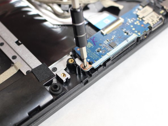

  3. Lenovo IdeaPad Flex 4-1470 USB/SD Card Hub Replacement, USB/SD Card Hub: crwdns2935265:03crwdnd2935265:01crwdnd2935265:02crwdne2935265:0 Lenovo IdeaPad Flex 4-1470 USB/SD Card Hub Replacement, USB/SD Card Hub: crwdns2935265:03crwdnd2935265:02crwdnd2935265:02crwdne2935265:0
    • Remove the 4mm screw with a JIS #0 screwdriver.
  4. Lenovo IdeaPad Flex 4-1470 USB/SD Card Hub Replacement: crwdns2935265:04crwdnd2935265:01crwdnd2935265:01crwdne2935265:0
    • Remove the ribbon cable.
  5. Lenovo IdeaPad Flex 4-1470 USB/SD Card Hub Replacement: crwdns2935265:05crwdnd2935265:01crwdnd2935265:01crwdne2935265:0
    • Remove the existing USB hub and replace it with the new hub.
