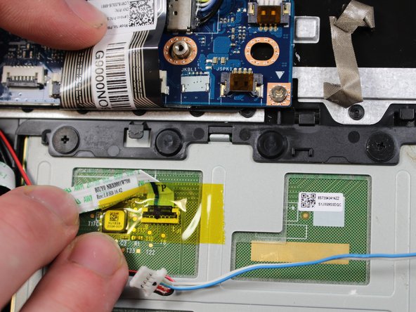

  6. Lenovo IdeaPad Flex 4-1470 Touchpad Replacement, Touchpad: crwdns2935265:06crwdnd2935265:01crwdnd2935265:01crwdne2935265:0
    • Locate the touchpad.
  7. Lenovo IdeaPad Flex 4-1470 Touchpad Replacement: crwdns2935265:07crwdnd2935265:01crwdnd2935265:02crwdne2935265:0 Lenovo IdeaPad Flex 4-1470 Touchpad Replacement: crwdns2935265:07crwdnd2935265:02crwdnd2935265:02crwdne2935265:0
    • Remove the three ribbon cables surrounding the touch pad.
  8. Lenovo IdeaPad Flex 4-1470 Touchpad Replacement: crwdns2935265:08crwdnd2935265:01crwdnd2935265:01crwdne2935265:0
    • Lift the base of the laptop from the screen and gently push the touchpad to remove.
