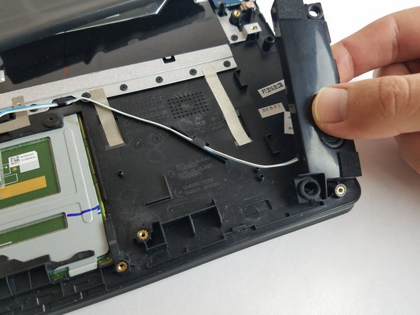

    • The speakers are not screwed or bolted in like any other components. They have two rubber grommets at each end which hold it in with friction.
    • Starting with the speaker on the right, use your fingers to lift both ends of the speaker off.
    • The grommets may fall off when removing the speaker. When reassembling make sure you place the grommets back into the notches on the speaker before trying to mount the speaker. The specific orientation and position doesn't matter
  7. Lenovo IdeaPad Flex 4-1470 Speaker Replacement: crwdns2935265:07crwdnd2935265:01crwdnd2935265:01crwdne2935265:0
    • In addition to the grommets, the speaker wire running to the motherboard is clipped down.
    • Remove speaker wire from the clips.

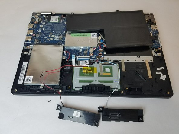

    • Repeat the previous steps for the other speaker.

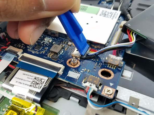

    • Remove the wire shown using the plastic opening tool.
  10. Lenovo IdeaPad Flex 4-1470 Speaker Replacement: crwdns2935265:010crwdnd2935265:01crwdnd2935265:02crwdne2935265:0 Lenovo IdeaPad Flex 4-1470 Speaker Replacement: crwdns2935265:010crwdnd2935265:02crwdnd2935265:02crwdne2935265:0

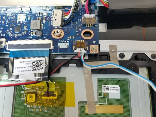

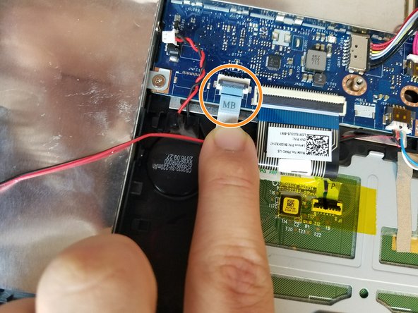

    • Use the Plastic Opening tool to flip open the ribbon cable clip shown.
    • Pull gently on the ribbon cable to disconnect it from the motherboard.
  11. Lenovo IdeaPad Flex 4-1470 Speaker Replacement: crwdns2935265:011crwdnd2935265:01crwdnd2935265:03crwdne2935265:0 Lenovo IdeaPad Flex 4-1470 Speaker Replacement: crwdns2935265:011crwdnd2935265:02crwdnd2935265:03crwdne2935265:0 Lenovo IdeaPad Flex 4-1470 Speaker Replacement: crwdns2935265:011crwdnd2935265:03crwdnd2935265:03crwdne2935265:0
    • Now that both speaker wires are free, disconnect the speakers from motherboard using two plastic opening tools.
    • Keep in mind that the red and black wires lead to the left speaker and the blue and white wires lead to the right speakers.
