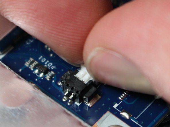

  5. Lenovo IdeaPad Flex 4-1470 Cmos battery Replacement: crwdns2935265:05crwdnd2935265:01crwdnd2935265:02crwdne2935265:0 Lenovo IdeaPad Flex 4-1470 Cmos battery Replacement: crwdns2935265:05crwdnd2935265:02crwdnd2935265:02crwdne2935265:0
    • Remove the red and black annotated cable, pulling white head out of black port as indicated.
