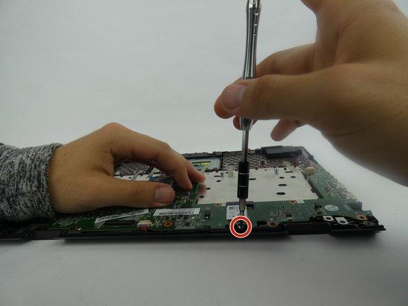

  6. Lenovo IdeaPad Flex 4-1130 Wi-Fi Card Replacement, Wi-Fi Card: crwdns2935265:06crwdnd2935265:01crwdnd2935265:02crwdne2935265:0 Lenovo IdeaPad Flex 4-1130 Wi-Fi Card Replacement, Wi-Fi Card: crwdns2935265:06crwdnd2935265:02crwdnd2935265:02crwdne2935265:0
    • Remove one 5mm screw.

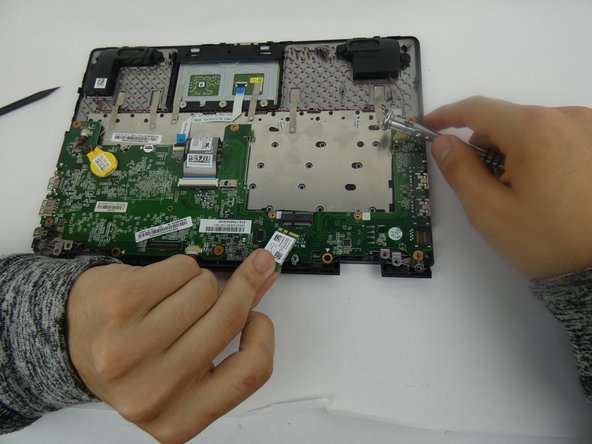

  7. Lenovo IdeaPad Flex 4-1130 Wi-Fi Card Replacement: crwdns2935265:07crwdnd2935265:01crwdnd2935265:02crwdne2935265:0 Lenovo IdeaPad Flex 4-1130 Wi-Fi Card Replacement: crwdns2935265:07crwdnd2935265:02crwdnd2935265:02crwdne2935265:0
    • Remove the Wi-Fi card from the motherboard socket.
