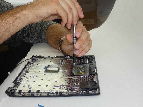

  11. Lenovo IdeaPad Flex 4-1130 Touchpad Replacement, Touchpad: crwdns2935265:011crwdnd2935265:01crwdnd2935265:01crwdne2935265:0
    • Due to the amount of force required to remove the screws holding the touchpad, we recommend removing the motherboard before attempting this replacement to reduce the chances of damaging any components.
    • Lift up the black tab on the ZIF connector and pull the ribbon cable out.
  12. Lenovo IdeaPad Flex 4-1130 Touchpad Replacement: crwdns2935265:012crwdnd2935265:01crwdnd2935265:02crwdne2935265:0 Lenovo IdeaPad Flex 4-1130 Touchpad Replacement: crwdns2935265:012crwdnd2935265:02crwdnd2935265:02crwdne2935265:0
    • Remove three 8mm screws.
  13. Lenovo IdeaPad Flex 4-1130 Touchpad Replacement: crwdns2935265:013crwdnd2935265:01crwdnd2935265:01crwdne2935265:0
    • Push the touchpad outwards to remove it.
