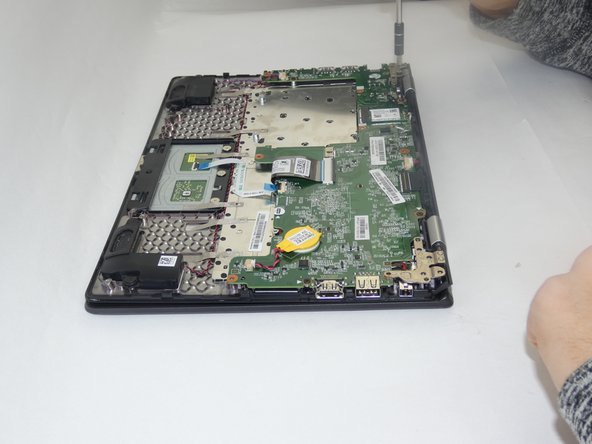

    • Remove the connector attaching the battery to the motherboard.
  4. Lenovo IdeaPad Flex 4-1130 Screen Replacement: crwdns2935265:04crwdnd2935265:01crwdnd2935265:01crwdne2935265:0
    • Remove the four 4mm screws on the battery.
  5. Lenovo IdeaPad Flex 4-1130 Screen Replacement: crwdns2935265:05crwdnd2935265:01crwdnd2935265:01crwdne2935265:0
    • Lift the battery with a spudger and remove.

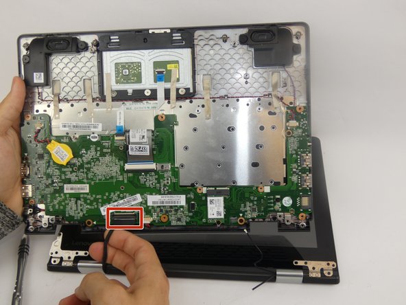

  6. Lenovo IdeaPad Flex 4-1130 Screen Replacement, Screen: crwdns2935265:06crwdnd2935265:01crwdnd2935265:02crwdne2935265:0 Lenovo IdeaPad Flex 4-1130 Screen Replacement, Screen: crwdns2935265:06crwdnd2935265:02crwdnd2935265:02crwdne2935265:0
    • Remove six 7mm screws.
  7. Lenovo IdeaPad Flex 4-1130 Screen Replacement: crwdns2935265:07crwdnd2935265:01crwdnd2935265:02crwdne2935265:0 Lenovo IdeaPad Flex 4-1130 Screen Replacement: crwdns2935265:07crwdnd2935265:02crwdnd2935265:02crwdne2935265:0
    • Remove two connector cables.
    • Separate the two unhinged parts.

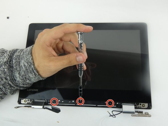

  9. Lenovo IdeaPad Flex 4-1130 Screen Replacement: crwdns2935265:09crwdnd2935265:01crwdnd2935265:02crwdne2935265:0 Lenovo IdeaPad Flex 4-1130 Screen Replacement: crwdns2935265:09crwdnd2935265:02crwdnd2935265:02crwdne2935265:0
    • Use the black nylon spudger to remove the long plastic covering underneath the screen.
    • Remove three 6mm screws.

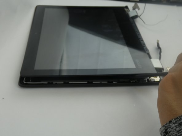

  10. Lenovo IdeaPad Flex 4-1130 Screen Replacement: crwdns2935265:010crwdnd2935265:01crwdnd2935265:02crwdne2935265:0 Lenovo IdeaPad Flex 4-1130 Screen Replacement: crwdns2935265:010crwdnd2935265:02crwdnd2935265:02crwdne2935265:0
    • Use the black nylon spudger to lift and separate the screen from the plastic back cover.

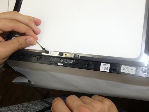

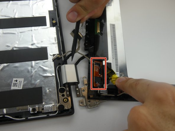

  11. Lenovo IdeaPad Flex 4-1130 Screen Replacement: crwdns2935265:011crwdnd2935265:01crwdnd2935265:02crwdne2935265:0 Lenovo IdeaPad Flex 4-1130 Screen Replacement: crwdns2935265:011crwdnd2935265:02crwdnd2935265:02crwdne2935265:0
    • Peel off tape and remove the cable.
  12. Lenovo IdeaPad Flex 4-1130 Screen Replacement: crwdns2935265:012crwdnd2935265:01crwdnd2935265:02crwdne2935265:0 Lenovo IdeaPad Flex 4-1130 Screen Replacement: crwdns2935265:012crwdnd2935265:02crwdnd2935265:02crwdne2935265:0
    • Remove the connector chip.
  13. Lenovo IdeaPad Flex 4-1130 Screen Replacement: crwdns2935265:013crwdnd2935265:01crwdnd2935265:02crwdne2935265:0 Lenovo IdeaPad Flex 4-1130 Screen Replacement: crwdns2935265:013crwdnd2935265:02crwdnd2935265:02crwdne2935265:0
    • Peel tape and remove cable underneath.
