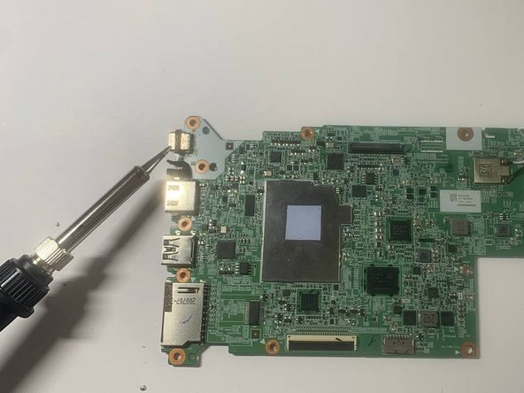

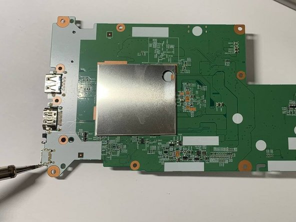

  5. Lenovo IdeaPad Flex 3 CB 11M735 Charging Port Replacement: crwdns2935265:05crwdnd2935265:01crwdnd2935265:03crwdne2935265:0 Lenovo IdeaPad Flex 3 CB 11M735 Charging Port Replacement: crwdns2935265:05crwdnd2935265:02crwdnd2935265:03crwdne2935265:0 Lenovo IdeaPad Flex 3 CB 11M735 Charging Port Replacement: crwdns2935265:05crwdnd2935265:03crwdnd2935265:03crwdne2935265:0
    • Remove the motherboard from the laptop.
    • Plug in your soldering iron and set it to approximately 350°F.
    • Be cautious to avoid burns, and always use a proper stand. Keep the soldering iron away from flammable surfaces.
    • Flip the motherboard over and carefully desolder the small holes using the tip of your heated soldering iron. This will melt the solder, allowing you to remove the USB-C port.
    • Position the new USB 3.1 Type-C 16-pin female connector in place, then reheat the solder to secure it to the motherboard.
