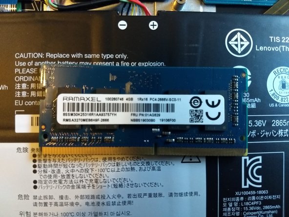

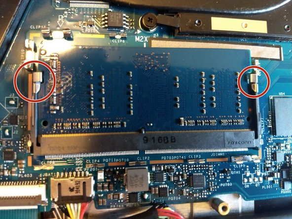

  5. Lenovo IdeaPad Flex 14API Upgrade Guide, RAM: crwdns2935265:05crwdnd2935265:01crwdnd2935265:03crwdne2935265:0 Lenovo IdeaPad Flex 14API Upgrade Guide, RAM: crwdns2935265:05crwdnd2935265:02crwdnd2935265:03crwdne2935265:0 Lenovo IdeaPad Flex 14API Upgrade Guide, RAM: crwdns2935265:05crwdnd2935265:03crwdnd2935265:03crwdne2935265:0
    • On the right are the four soldered DRAM modules. Interestingly, they (and the Ram stick) are both rated for 2666 mhz, but the bios locks the speed to 2400mhz.
    • The stick is under the metal box on the left. I have no idea what the box is for.
    • The box is held in by friction clips. It's tricky, but if you pull straight up it should just slide off.
    • Once you have the box pulled off, you can remove the ram. It is held in by two metal clips - push these outwards and it'll pop up so you can pull it out.
    • To replace the ram, slide it in at an angle until the gold contacts are almost covered. After this, you should be able to push it down and the clips will snap it back into place. If the clips aren't doing this, it's not in the slot far enough.

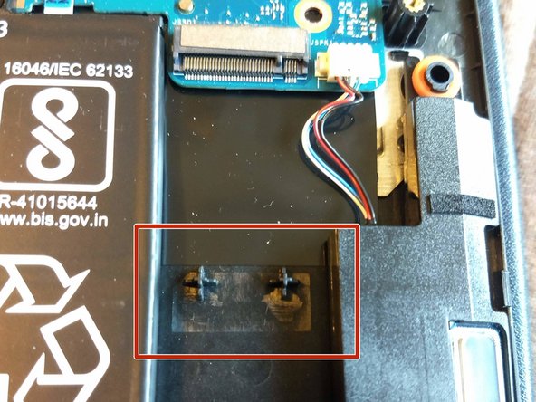

  6. Lenovo IdeaPad Flex 14API Upgrade Guide, SSd: crwdns2935265:06crwdnd2935265:01crwdnd2935265:02crwdne2935265:0 Lenovo IdeaPad Flex 14API Upgrade Guide, SSd: crwdns2935265:06crwdnd2935265:02crwdnd2935265:02crwdne2935265:0
    • The SSD is a regular ol' m.2 slot. You do have to peel back the Lenovo sticker in order to unscrew it (Phillips). It doesn't say anything about warranty void if removed on the sticker, but remove at your own risk.
    • The SSD is a Samsung 961. Decent enough module. It is single sided, so I'm not sure if the standoffs will cause compatibility issues with double sided modules. The standoffs are plastic, so could be filed down if absolutely necessary.
    • There should be enough room for those thin "sticker" heatsinks, but not for anything more than a mm or two.

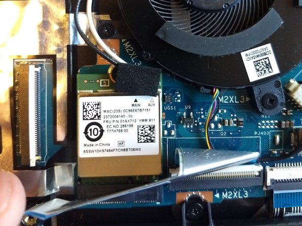

  7. Lenovo IdeaPad Flex 14API Upgrade Guide, WiFi and Bluetooth: crwdns2935265:07crwdnd2935265:01crwdnd2935265:02crwdne2935265:0 Lenovo IdeaPad Flex 14API Upgrade Guide, WiFi and Bluetooth: crwdns2935265:07crwdnd2935265:02crwdnd2935265:02crwdne2935265:0
    • The WiFi module is underneath a ribbon cable. To pull it back, flip up the white latch and it'll come right out easily. (Do not attempt to remove it without first lifting the latch).
    • I have no idea what module this. Device manager in windows says it's a Realtek.
    • To upgrade it or replace it, you just need to remove the black pad, unscrew the screw underneath, and disconnect the antennae. After that, it should come out like the m.2 drive.
