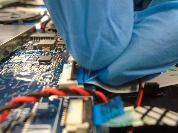

  14. Lenovo IdeaPad FLEX 4-1580 Circuit Board Replacement: crwdns2935265:014crwdnd2935265:01crwdnd2935265:01crwdne2935265:0
    • Then you will lift up the flap that holds these wires down.

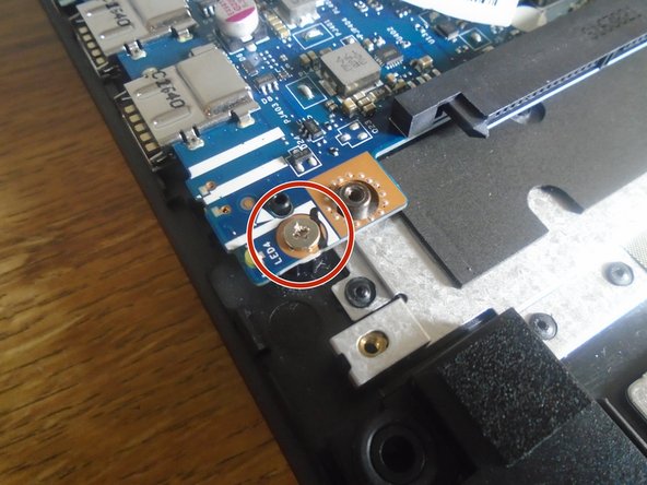

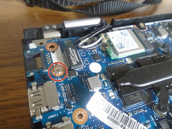

  15. Lenovo IdeaPad FLEX 4-1580 Circuit Board Replacement: crwdns2935265:015crwdnd2935265:01crwdnd2935265:03crwdne2935265:0 Lenovo IdeaPad FLEX 4-1580 Circuit Board Replacement: crwdns2935265:015crwdnd2935265:02crwdnd2935265:03crwdne2935265:0 Lenovo IdeaPad FLEX 4-1580 Circuit Board Replacement: crwdns2935265:015crwdnd2935265:03crwdnd2935265:03crwdne2935265:0
    • After the flap is opened then you will have to go and remove all the screws holding the circuit board to the computer.
  16. Lenovo IdeaPad FLEX 4-1580 Circuit Board Replacement: crwdns2935265:016crwdnd2935265:01crwdnd2935265:01crwdne2935265:0
    • After the screws are removed from the circuit board, you will have to remove these last screws to remove it completely.
