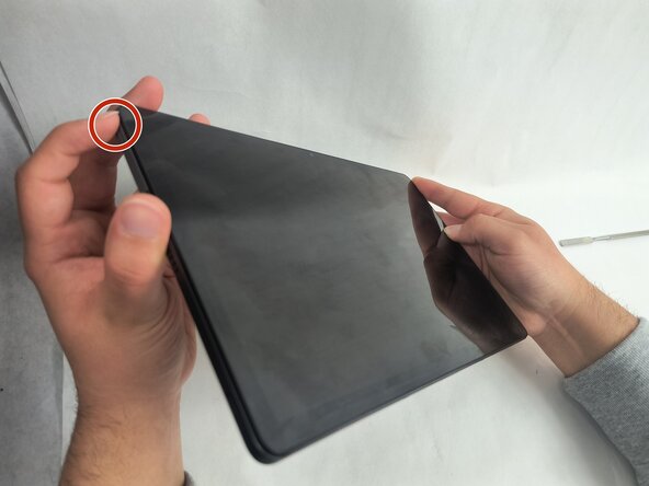

  2. Lenovo IdeaPad Duet 3 Chromebook 11Q727 Speakers Replacement: crwdns2935265:02crwdnd2935265:01crwdnd2935265:02crwdne2935265:0 Lenovo IdeaPad Duet 3 Chromebook 11Q727 Speakers Replacement: crwdns2935265:02crwdnd2935265:02crwdnd2935265:02crwdne2935265:0
    • Insert a spudger into the ridge between the screen and the back of the device, creating a small gap.
    • Run the spudger along the edge of the screen and around the corners to separate the screen from the rest of the device.

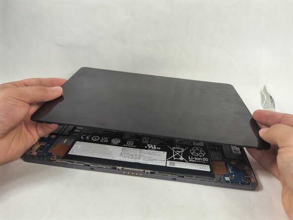

    • Be careful not to use more force than necessary with the metal spudger or else the device could potentially be scratched.
    • Do not fully lift or pull the screen away from the device once it is loose because the internal connectors are still attached.

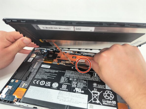

  3. Lenovo IdeaPad Duet 3 Chromebook 11Q727 Speakers Replacement: crwdns2935265:03crwdnd2935265:01crwdnd2935265:03crwdne2935265:0 Lenovo IdeaPad Duet 3 Chromebook 11Q727 Speakers Replacement: crwdns2935265:03crwdnd2935265:02crwdnd2935265:03crwdne2935265:0 Lenovo IdeaPad Duet 3 Chromebook 11Q727 Speakers Replacement: crwdns2935265:03crwdnd2935265:03crwdnd2935265:03crwdne2935265:0
    • Lift the small tab on the orange connector.
    • Separate the screen from the back of the device.

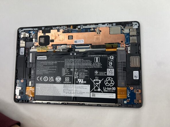

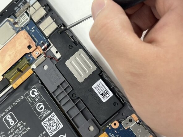

  4. Lenovo IdeaPad Duet 3 Chromebook 11Q727 Speakers Replacement, Speakers: crwdns2935265:04crwdnd2935265:01crwdnd2935265:02crwdne2935265:0 Lenovo IdeaPad Duet 3 Chromebook 11Q727 Speakers Replacement, Speakers: crwdns2935265:04crwdnd2935265:02crwdnd2935265:02crwdne2935265:0
    • Remove four 3 mm screws using a Phillips #00 screwdriver.

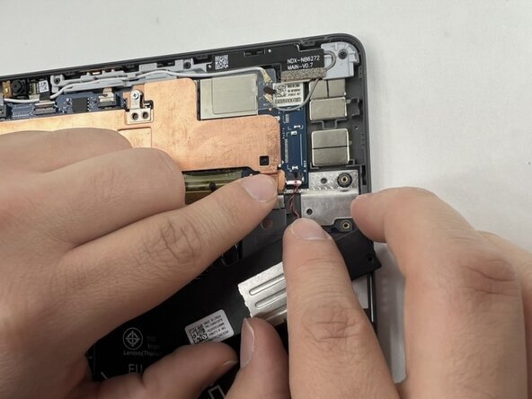

  5. Lenovo IdeaPad Duet 3 Chromebook 11Q727 Speakers Replacement: crwdns2935265:05crwdnd2935265:01crwdnd2935265:02crwdne2935265:0 Lenovo IdeaPad Duet 3 Chromebook 11Q727 Speakers Replacement: crwdns2935265:05crwdnd2935265:02crwdnd2935265:02crwdne2935265:0
    • Disconnect the speaker by gently but firmly pulling the white connector directly from the device.
    • Remove the speaker.
    • Repeat for the left speaker.
    • The process is identical, except that on the left speaker, there are three 3 mm screws instead of four.
