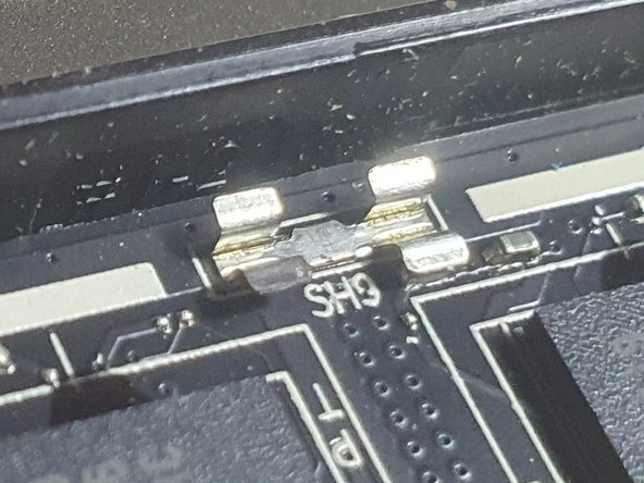

  5. Lenovo IdeaPad 720S-13IKB Teardown, Remove Covers: crwdns2935265:05crwdnd2935265:01crwdnd2935265:02crwdne2935265:0 Lenovo IdeaPad 720S-13IKB Teardown, Remove Covers: crwdns2935265:05crwdnd2935265:02crwdnd2935265:02crwdne2935265:0
    • Remove Screws with PH1
    • Remove Screws with PH0
    • Remove RAM cover
    • All covers are also secured using contact clips (Picture 2). Just pull them out

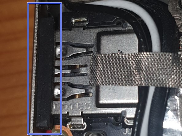

  8. Lenovo IdeaPad 720S-13IKB Teardown, Remove Motherboard: crwdns2935265:08crwdnd2935265:01crwdnd2935265:02crwdne2935265:0 Lenovo IdeaPad 720S-13IKB Teardown, Remove Motherboard: crwdns2935265:08crwdnd2935265:02crwdnd2935265:02crwdne2935265:0
    • Remove screws using PH0
    • Remove screws using PH1 and take m.2 parts out
    • Dissconnect cables
    • Disconnect Display Cable
    • No Idea how to connect Display Cable (Tips welcome)
    • Push Moterboard to the left and take it out.
    • At the USB-A Port is some cushion to keep the Motherboard in place.
