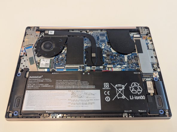

  1. Lenovo IdeaPad 530S-14IKB Keyboard / touchpad assembly Replacement, Remove the bottom cover: crwdns2935265:01crwdnd2935265:01crwdnd2935265:02crwdne2935265:0 Lenovo IdeaPad 530S-14IKB Keyboard / touchpad assembly Replacement, Remove the bottom cover: crwdns2935265:01crwdnd2935265:02crwdnd2935265:02crwdne2935265:0
    • Unscrew all 10 T5 screws. The screws are all the same length.
    • Remove the bottom cover carefully. Maybe it is necessary to use a pick or spudger.

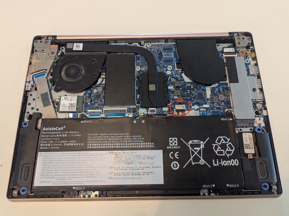

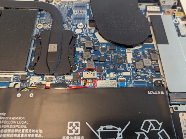

  2. Lenovo IdeaPad 530S-14IKB Keyboard / touchpad assembly Replacement, Disconnect and remove the battery: crwdns2935265:02crwdnd2935265:01crwdnd2935265:03crwdne2935265:0 Lenovo IdeaPad 530S-14IKB Keyboard / touchpad assembly Replacement, Disconnect and remove the battery: crwdns2935265:02crwdnd2935265:02crwdnd2935265:03crwdne2935265:0 Lenovo IdeaPad 530S-14IKB Keyboard / touchpad assembly Replacement, Disconnect and remove the battery: crwdns2935265:02crwdnd2935265:03crwdnd2935265:03crwdne2935265:0
    • Remove the 4 screws holding the battery an disconnect it.

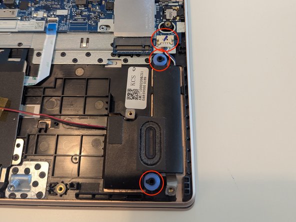

  3. Lenovo IdeaPad 530S-14IKB Keyboard / touchpad assembly Replacement, Remove speakers: crwdns2935265:03crwdnd2935265:01crwdnd2935265:02crwdne2935265:0 Lenovo IdeaPad 530S-14IKB Keyboard / touchpad assembly Replacement, Remove speakers: crwdns2935265:03crwdnd2935265:02crwdnd2935265:02crwdne2935265:0
    • Pull up on the left speaker.
    • Untangle the cable connecting the left and right speakers (the pass under the protector covering the touchpad).
    • Disconnect the right speaker from the mainboard and pull it up to remove the two speakers.

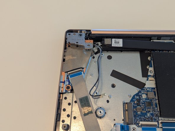

  8. Lenovo IdeaPad 530S-14IKB Keyboard / touchpad assembly Replacement, Unscrew daughterboard on the left side: crwdns2935265:08crwdnd2935265:01crwdnd2935265:01crwdne2935265:0
    • Remove the one screw holding the daughterboard on the right side.

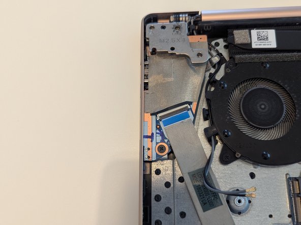

  11. Lenovo IdeaPad 530S-14IKB Keyboard / touchpad assembly Replacement, Remove the fan: crwdns2935265:011crwdnd2935265:01crwdnd2935265:03crwdne2935265:0 Lenovo IdeaPad 530S-14IKB Keyboard / touchpad assembly Replacement, Remove the fan: crwdns2935265:011crwdnd2935265:02crwdnd2935265:03crwdne2935265:0 Lenovo IdeaPad 530S-14IKB Keyboard / touchpad assembly Replacement, Remove the fan: crwdns2935265:011crwdnd2935265:03crwdnd2935265:03crwdne2935265:0
    • Remove the 3 screws holding the fan.
    • Disconnect the fan from the mainboard.
    • Untangle the antenna cables from the fan and remove the fan.
