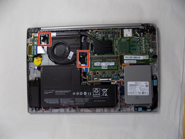

  13. Lenovo IdeaPad 330S-15ARR Touch Pad Replacement, Touch Pad: crwdns2935265:013crwdnd2935265:01crwdnd2935265:01crwdne2935265:0
    • Remove three 3 mm screws connecting the motherboard to the frame of the laptop.
  14. Lenovo IdeaPad 330S-15ARR Touch Pad Replacement: crwdns2935265:014crwdnd2935265:01crwdnd2935265:02crwdne2935265:0 Lenovo IdeaPad 330S-15ARR Touch Pad Replacement: crwdns2935265:014crwdnd2935265:02crwdnd2935265:02crwdne2935265:0
    • Remove the Wi-Fi card by pulling it out to the right.
    • Detach the black cable from the motherboard.
  15. Lenovo IdeaPad 330S-15ARR Touch Pad Replacement: crwdns2935265:015crwdnd2935265:01crwdnd2935265:01crwdne2935265:0
    • Push the top right of the motherboard down and left.
    • Make sure there is enough clearance for the USB ports on the right to not be damaged as they can interfere with the case if not pushed in enough.
  16. Lenovo IdeaPad 330S-15ARR Touch Pad Replacement: crwdns2935265:016crwdnd2935265:01crwdnd2935265:01crwdne2935265:0
    • Remove the four 1.5 mm silver screws using a Phillips #00 screwdriver.
    • Remove the three 1.5 mm black screws using a Phillips #00 screwdriver.
  17. Lenovo IdeaPad 330S-15ARR Touch Pad Replacement: crwdns2935265:017crwdnd2935265:01crwdnd2935265:01crwdne2935265:0
    • Disconnect the silver bar holding down the frame to the touchpad, and remove the gold tape.
    • Remove the frame and pull straight up on the touch pad to remove it.
