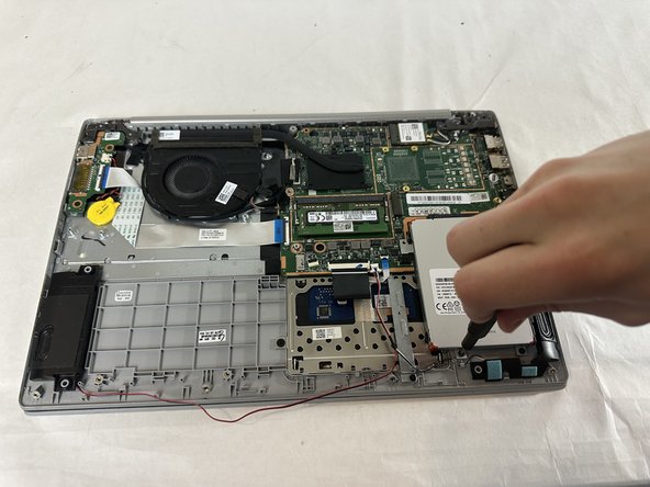

    • Remove the six 3 mm screws from the black board using a Phillips #00 screwdriver.
  3. Lenovo IdeaPad 330S-15ARR Hard Drive Replacement: crwdns2935265:03crwdnd2935265:01crwdnd2935265:02crwdne2935265:0 Lenovo IdeaPad 330S-15ARR Hard Drive Replacement: crwdns2935265:03crwdnd2935265:02crwdnd2935265:02crwdne2935265:0
    • Use a Phillips #00 screwdriver to remove the two 3 mm screws that hold the hard drive down in place.

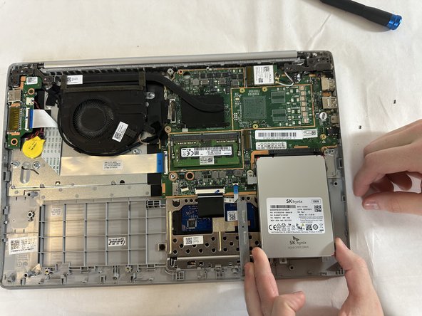

  4. Lenovo IdeaPad 330S-15ARR Hard Drive Replacement: crwdns2935265:04crwdnd2935265:01crwdnd2935265:03crwdne2935265:0 Lenovo IdeaPad 330S-15ARR Hard Drive Replacement: crwdns2935265:04crwdnd2935265:02crwdnd2935265:03crwdne2935265:0 Lenovo IdeaPad 330S-15ARR Hard Drive Replacement: crwdns2935265:04crwdnd2935265:03crwdnd2935265:03crwdne2935265:0

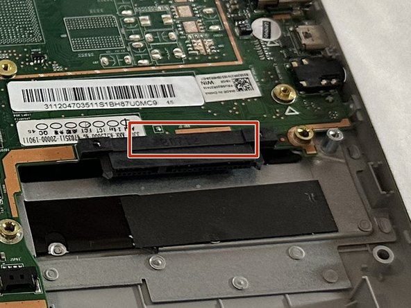

    • Use a Jimmy to remove the blue and black bracket that surrounds the hard drive.
    • Pull the hard drive from the bottom to release it from its black port labeled S0712.

  6. Lenovo IdeaPad 330S-15ARR Hard Drive Replacement: crwdns2935265:06crwdnd2935265:01crwdnd2935265:01crwdne2935265:0
    • Lift the silver case and replace the hard drive with your new hard drive.
