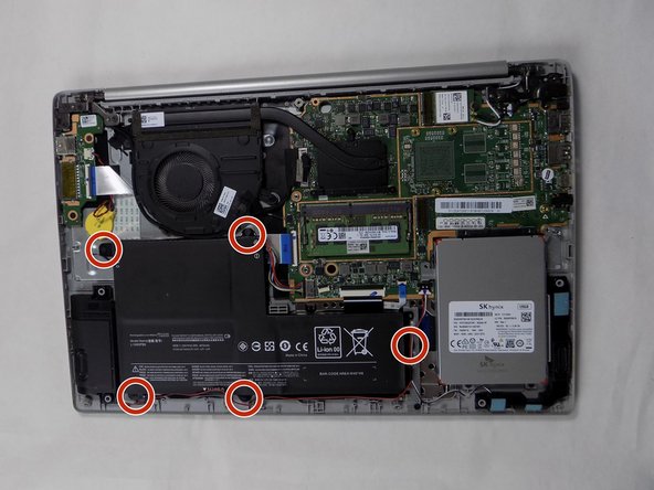

  2. Lenovo IdeaPad 330S-15ARR Battery Replacement, Battery: crwdns2935265:02crwdnd2935265:01crwdnd2935265:02crwdne2935265:0 Lenovo IdeaPad 330S-15ARR Battery Replacement, Battery: crwdns2935265:02crwdnd2935265:02crwdnd2935265:02crwdne2935265:0
    • Remove the five 3 mm screws securing the battery using a Phillips #00 screwdriver.
