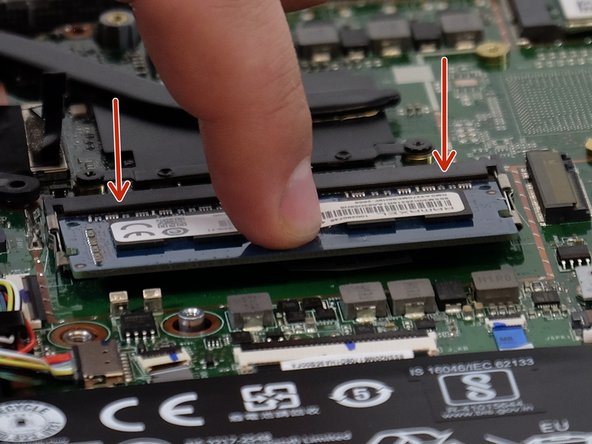

    • Now, take your new RAM module and locate the notch on it.
  9. Lenovo IdeaPad 330S-14IKB RAM Replacement: crwdns2935265:09crwdnd2935265:01crwdnd2935265:01crwdne2935265:0
    • Align the notch on your replacement RAM as shown in the previous step with the corresponding slot on the device's RAM slot.
  10. Lenovo IdeaPad 330S-14IKB RAM Replacement: crwdns2935265:010crwdnd2935265:01crwdnd2935265:02crwdne2935265:0 Lenovo IdeaPad 330S-14IKB RAM Replacement: crwdns2935265:010crwdnd2935265:02crwdnd2935265:02crwdne2935265:0
    • Gently insert the RAM module.
    • Once it's as far in as it can go, lower it slowly until the metal clips lock it into place.
    • You should hear an audible click when it's securely in place.
