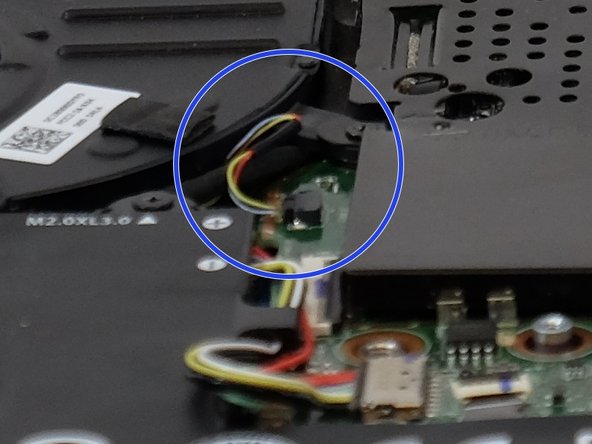

  8. Lenovo IdeaPad 330S-14IKB Fan Replacement: crwdns2935265:08crwdnd2935265:01crwdnd2935265:02crwdne2935265:0 Lenovo IdeaPad 330S-14IKB Fan Replacement: crwdns2935265:08crwdnd2935265:02crwdnd2935265:02crwdne2935265:0
    • Before removing the fan, locate a small set of yellow, red, blue, and black wires on the right side of the fan.
    • Gently remove them from the connector without pulling on the wires.
    • You can use a screwdriver or a similar tool to assist in this step.

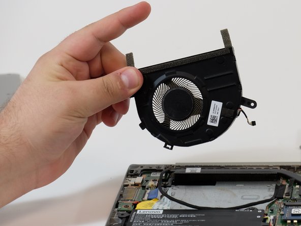

  9. Lenovo IdeaPad 330S-14IKB Fan Replacement: crwdns2935265:09crwdnd2935265:01crwdnd2935265:02crwdne2935265:0 Lenovo IdeaPad 330S-14IKB Fan Replacement: crwdns2935265:09crwdnd2935265:02crwdnd2935265:02crwdne2935265:0
    • Disconnect the large black wire connected to the slot on the side of your fan.
    • Remove your fan.
