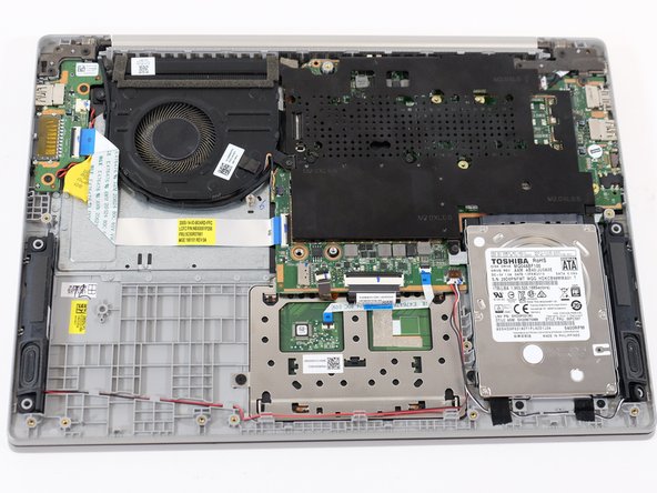

  4. Lenovo IdeaPad 330S-14IKB Battery Replacement: crwdns2935265:04crwdnd2935265:01crwdnd2935265:01crwdne2935265:0
    • Locate the battery in the bottom left corner.
  5. Lenovo IdeaPad 330S-14IKB Battery Replacement: crwdns2935265:05crwdnd2935265:01crwdnd2935265:01crwdne2935265:0
    • Remove the 5 screws that secure the battery in place.
    • (Black, 3.45mm Phillips #0)

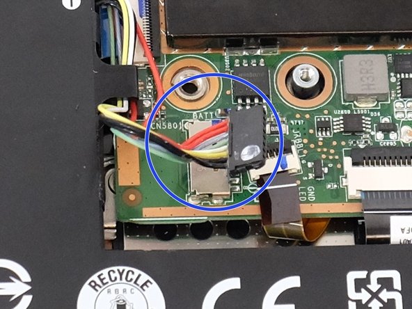

    • Near the positive and negative symbols on the battery, you'll find a wire connected to the motherboard.
    • Gently unplug this wire.
  7. Lenovo IdeaPad 330S-14IKB Battery Replacement: crwdns2935265:07crwdnd2935265:01crwdnd2935265:02crwdne2935265:0 Lenovo IdeaPad 330S-14IKB Battery Replacement: crwdns2935265:07crwdnd2935265:02crwdnd2935265:02crwdne2935265:0
    • There is a wire clipped to the side of the battery next to the hard drive; unhook this wire.
    • With the wire disconnected, remove the old battery.
