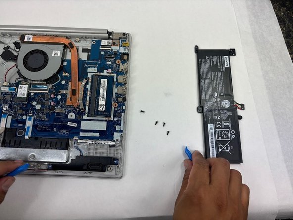

  2. Lenovo IdeaPad 330-15IKB 81DE Speaker Replacement, Battery: crwdns2935265:02crwdnd2935265:01crwdnd2935265:03crwdne2935265:0 Lenovo IdeaPad 330-15IKB 81DE Speaker Replacement, Battery: crwdns2935265:02crwdnd2935265:02crwdnd2935265:03crwdne2935265:0 Lenovo IdeaPad 330-15IKB 81DE Speaker Replacement, Battery: crwdns2935265:02crwdnd2935265:03crwdnd2935265:03crwdne2935265:0
    • Remove the three 6 mm screws from the tabs surrounding the battery using a Phillips #0 screwdriver.

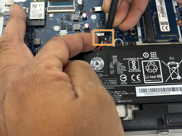

    • Carefully separate the battery connector from the device using a spudger.
    • Lift the battery up and remove it from the device.
