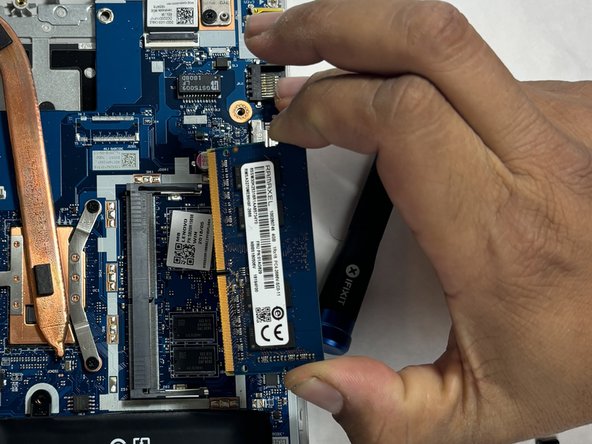

    • Ensure the laptop is powered off.
    • Turn the device over so the bottom is facing up.
    • Remove the 13 6 mm screws from the bottom of the device using a Phillips #0 screwdriver.
    • Carefully glide a Jimmy along the seam of the casing.
    • Remove the back cover of the laptop.
  2. Lenovo IdeaPad 330-15IKB 81DE RAM Replacement, RAM: crwdns2935265:02crwdnd2935265:01crwdnd2935265:02crwdne2935265:0 Lenovo IdeaPad 330-15IKB 81DE RAM Replacement, RAM: crwdns2935265:02crwdnd2935265:02crwdnd2935265:02crwdne2935265:0
    • Spread the retaining clips on either side of the RAM.
    • Remove the RAM from the device.
