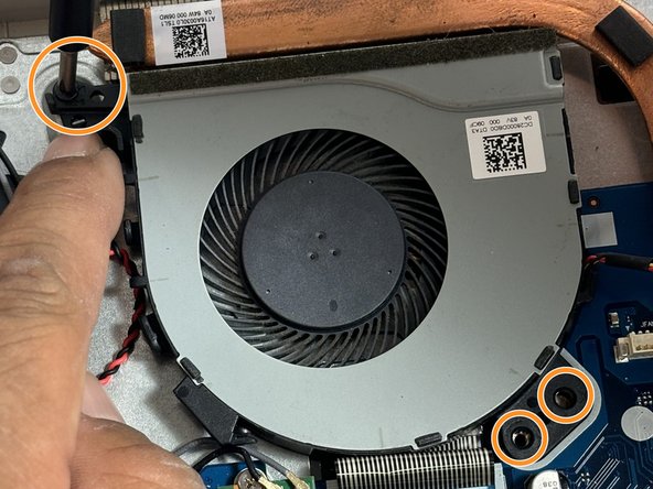

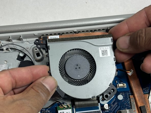

  2. Lenovo IdeaPad 330-15IKB 81DE Fan Replacement, Fan: crwdns2935265:02crwdnd2935265:01crwdnd2935265:03crwdne2935265:0 Lenovo IdeaPad 330-15IKB 81DE Fan Replacement, Fan: crwdns2935265:02crwdnd2935265:02crwdnd2935265:03crwdne2935265:0 Lenovo IdeaPad 330-15IKB 81DE Fan Replacement, Fan: crwdns2935265:02crwdnd2935265:03crwdnd2935265:03crwdne2935265:0
    • Carefully unplug the fan connector.
    • Remove the three 3 mm screws to the left of the fan using a Phillips #0 screwdriver.
    • Lift the fan up and remove it from the back of the device.
